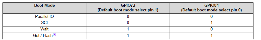

How to use EMU_BOOTCTRL register ? How can I give CAN Boot0 value (0x07) ? Where can I access it from ?
I want to test a example code (CAN Loopback or others). What are my steps ?
The last question is I want that boot mode is CAN, while pins are 1 . How can I do this ?

    EMU_BOOTCTRL register is located in 0xD00. Here is the procedure to have CANBOOT0 option in emulation boot mode.
    1) Connect to device
    2) Reset (Debugger reset) the device
    3) Write 0x075A to 0xD00 (EMU_BOOTCTRL register)
    4) Execute BOOTROM code with JTAG connected
    5) You will be in CANBOOT0
    Please refer to CPU1 Emulation Boot Flow chart in TRM for more details
    Note: Above method works only when device is connected with JTAG. In emulation boot mode the state of boot mode pins (GPIO72 / 84) are irrelevant.
