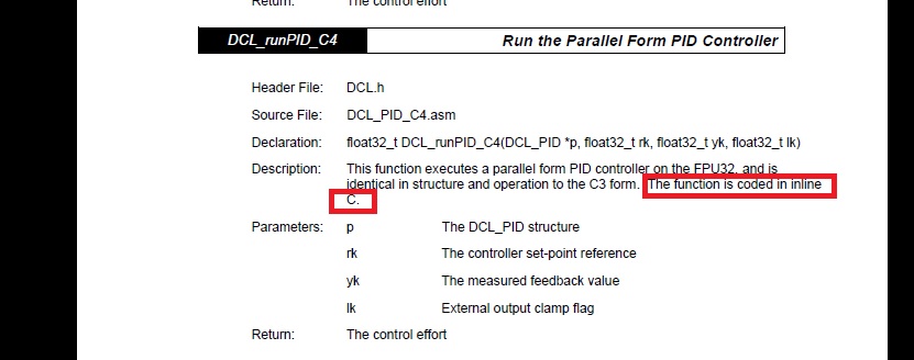

Hello All,
I've added the PID example here:  X:\ti\c2000\C2000Ware_1_00_04_00\libraries\control\DCL\c28\examples\F28069_PID
to my code - just trying to control a PWM output - and no matter what I seem to do - the PID output just 'bounces' between what I've set for Umax and Umin.
I've read the DCL doc which is a little sparse; I was wondering if there is an FAQ posted someplace regarding the TI provided PID code; and maybe seeing
the output alternate between Umax and Umin is just a config option I've goofed.

    I don't think it's anything you're doing. The output probably will behave that way with the settings in the code - this example was just to show how the controller might be added to a C program to implement closed loop control using the ADC as feedback. What's happening is the noise in the ADC reading is getting amplified greatly through the derivative path.
    Try this: run the code to the line in the ISR which loads yk, then change the controller coefficients to:
    Kp = 1.0f
    Kd = 0.0f
    Also, make sure the ADC input is not saturated. Then when you run the code you should see the output take on more reasonable values. Please let me know if that works.

    Correct: the floating point controllers in the DCL are intended to work with absolute, rather than normalized, data. Floating point buys us that. Typically only with the fixed point controllers do we need to be concerned about scaling. A lot of testing went into the DCL controllers before they were released so I'm confident they are functionally sound.
    By the way, a new version of the DCL will be deployed in a few days in C2000Ware v1.00.05. Look for that at the end of the month. None of the controller code has changed so you shouldn't have any issues if you decide to use it, however you will see some structural changes to the library and many more support functions which I hope you will like.
    Something I think we could do fairly quickly is to add a "Tuning Guide" document to help new users through the initial tuning phase. I don't think we need a new version for that. I'll pull something together in the coming weeks and if you don't mind I'd like to run it by you to get your feedback?

  • Richard,
    Some of my comments were regarding the DCL guide from 2015 - I was using GOOG and it brought up that version vs. the version from last fall - Nov. 2017 - but:
    I haven't been able to find C - just assembly language for the PID code.  I did find C in some of the older control suite releases.
    John W.

    Not bad - basically have what I call 'leading edge lock' with this.
    John
  • John,
    Glad to hear you're making progress. The statement about the C4 controller being written in inline C is a typo. The C3 nd C4 controllers are funcionally identical. C3 is written in inline C, C4 in assembly. The latter is faster. The same typo is in the latest manual so I will mark it for correction in the next release. Thanks.
    It is very likely you will be able to get better transient response from the non-linear PID, but tuning it will take longer. You may have to experiment with different 'alpha' & 'delta' terms. My advice is to set it up in linear mode first, then fix those gains and concentrate on 'alpha' & 'delta'. There'll be a separate application report on tuning the NLPID in a few months.
    One thing you'll need to keep an eye on is the cycle count. The non-linear law is based on a powf() function which is not cycle efficient in its' RTS form. This function only gets executed when the respective path is operating in its non-linear region, so worst case, you'll be computing powf() three times each run of the controller. The C28x 'FastRTS' library has an efficient implementation of powf() and I recommend using that. Please post back to let us know how you get on with tuning this controller.
    Getting to the non-TI questions: I expect both Houston and San Digeo will run, but I usually confirm about 2-3 weeks in advance. As is comes from Amazon I can't do a discount on the book, but if you come to either one I will give you a copy!
    Richard
  • Richard,
    OK - I will move on to tuning then - I'll try the FastRTS lib - I'll do the NL then go back to the Linear (C4) - see if I can tune that and then move back to the NL PID.
    I have a few corner cases with the HRCAP registers - when it is on the edge of reading a value (this is on the other side of an ECL AND Gate) - I can get very large readings that are inaccurate in the HRCAP CLK counts; so I'm either going to saturate and/or just skip that reading when it happens - other than that things are running pretty well based on what I'm seeing now.
    I thought you are going to have a tuning FAQ/Guide for me to take a look at?
    Also - thanks for letting me know about the seminars - I hope I can be at one of them and am looking forward to the book!
    John

    And here is the FastRTS.h include file that's in:
    X:\ti\c2000\C2000Ware_1_00_04_00\libraries\math\FPUfastRTS\c28\include
    // TI File $Revision: /main/2 $
    // Checkin $Date: July 10, 2008 16:11:44 $
    // This software is licensed for use with Texas Instruments C28x
    // family DSCs. This license was provided to you prior to installing
    // the software. You may review this license by consulting a copy of
    // the agreement in the doc directory of this library.
    // Copyright (C) 2007 Texas Instruments, Incorporated.
    // All Rights Reserved.
    // FILE: C28x_FPU_FastRTS.h
    // TITLE: Prototypes and Definitions for the C28x Fast RTS Library
    // DESCRIPTION:
    // These prototypes are for functions not found in the standard
    // RTS library.
    // For standard functions, include the appropriate header file as
    // usual. For example: math.h
    // $TI Release: C28x FPU fastRTS Library V1.00 $
    // $Release Date: August 6, 2008 $
    #ifndef C28X_FPU_FAST_RTS_H
    #define C28X_FPU_FAST_RTS_H
    #ifdef __cplusplus
    extern "C" {
    #endif
    // Standard C28x Data Types
    #ifndef DSP28_DATA_TYPES
    #define DSP28_DATA_TYPES
    typedef int int16;
    typedef long int32;
    typedef long long int64;
    typedef unsigned int Uint16;
    typedef unsigned long Uint32;
    typedef unsigned long long Uint64;
    typedef float float32;
    typedef long double float64;
    #endif
    // Function Prototypes
    float32 isqrt(float32 X);
    void sincos(float32 radian, float32* PtrSin, float32* PtrCos);
    #ifdef __cplusplus
    #endif /* extern "C" */
    #endif // - end of C28X_FPU_FAST_RTS_H
    // End of file.
    So, apparently, the lib and powf() function you are referring to are not what I have current access to regarding the TMS320F28069 resources I currently have.
    John

    John
  • John,
    Thank you for the data.  So, the sign of y is inverted relative to that of u.  Is that correct?
    Also, it looks like l(k) is at 0.7 - am I reading that correctly?
    Richard
  • John,
    Something looks wrong with this data.  The plots below are the -uk & yk data from your last post.  Notice the steps in -uk.  Also, why should yk change when -uk is static?
    ukyk.pdf
    Richard
  • Richard,
    y(k) isn't inverted intentionally - I was doing fabs() but not currently - that's dependent (I believe) on Umax, Umin, and r(k).
    And yes, l(k) was being pegged at 0.7 which is what I had Umax set for in that run. Doesn't mean that was necessarily correct.
    John
  • John,
    l(k) should only ever be 1 (integrator running) or 0 (loop saturated). Setting it to anything else would just scale the integral gain which you can do by changing Ki. For now, I recommend fixing l(k) at 1, just so it's out of the way.
    Richard
  • Richard,
    I was doing the open loop testing stepping y(k) from 100.f to 0.f - I'm assuming that is why. Umax and Umin are set.
    I'm wondering too if during the open loop run if the clamps are working correctly and maybe there 's some integral windup perhaps?
    I've tried varying r(k) also - just haven't posted that - would you like me to do that?
    If there's a specific open loop run you'd like to see - let me know and I'll post that. And if you want me to run the clamp and pid update
    functions or not.
    John
