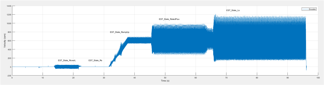

  • Sorry for the delay, I have been busy with other work and have just returned to this.  I will try to answer your questions and add more details.
    Could you please ensure the motor run well on this kit?
    I have been unable to get either Lab02a or Lab02c to correctly identify my motor parameters.  Both labs appear to exhibit the same behaviour.
    Starting at the beginning:
    1. EST_State_RoverL: the motor hums at ~300 Hz ~0.35° mechanical peak-to-peak.  Is there anything I should monitor here?
    2. EST_State_Rs: the software is unable to estimate Rs_Ohm correctly.  It is reporting ~1.5 Ohm, when the correct parameter should be ~0.5 Ohm according to my calculations in my previous post.
    3. EST_State_RampUp: the motor ramps up OK and runs at 600 rpm.
    4. EST_State_RatedFlux: the motor "flutters" at ~38 Hz ~650 rpm peak-to-peak (ouch!).  The rated flux value is estimated correctly as far as I can tell.
    5. EST_State_Ls: the motor "flutters" at ~32 Hz ~1000 rpm peak-to-peak (ouch!).  The Ls values are incorrectly estimated, ~2mH instead of ~0.5mH.
    If I reduce the PWM frequency or increase the current during the characterization the software drives the motor very poorly and loud noises are emit, so my choice of PWM frequency and currents may be marginal.  I am using 45 kHz PWM and my choice of currents are in my first post.
    See attached capture of angular velocity (mechanical):

  • You should have to run lab02b or lab02c well to identify the exact motor parameters, the torque is calculated per the motor parameters. The motor can't run smoothly to achieve a good performance, even to calculate the correct torque if the motor parameters are not right for InstaSPIN-FOC.
    You might set USER_MOTOR_RES_EST_CURRENT, USER_MOTOR_IND_EST_CURRENT, USER_MOTOR_MAX_CURRENT, and USER_MOTOR_FLUX_EST_FREQ_Hz based on your motor specification. You may refer to Chapter 4 (4.6.9/10/11/12) of InstaSPIN user’s guide (SPRUHJ1G) to set these parameters for identification.
