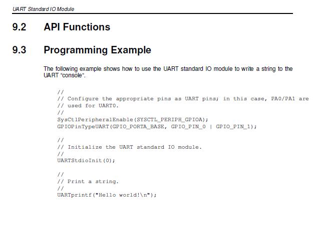

In the \C2000Ware_1_00_04_00\device_support\f2806x\MWare\utils folder there are 2 files: uartstdio and cmdline. How can I incorporate these utilities into my project? When I've tried to use them and then followed the example in the F2806x Firmware Development Package pdf on pg 123, I get compilation errors saying that SYSCTL_PERIPH_GPIOA isn't defined.
I've attached the pdf and a shot of the snippet I'm trying to get to work. F2806x-FRM-DEV-PKG-UG.pdf
Here's the snippet:
I've tried looking for a skeleton example that includes the utilities, but haven't had any success. Any suggestions on how I can incorporate these tools in my development environment would be fantastic.

  • The USB examples use these files. Have you looked at them?
    I suspect the documentation you've shown is incorrect. I don't think those GPIO functions actually exist on the F2806x. I'll file a bug report to get that corrected. Again, take a look at the USB examples to see how they initialize the UART IOs.
