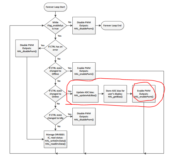

Dear Champs,
Below flow chart copied from motorware_hal_tutorial manual, I see that the adcbias is always get updated and PWM is always enabled in CTRL_State_OnLine.
1. My understanding is that the adcbias should be relates with the current amplifier offset, so this value won't change, why does the adcbias be get updated every time in online state?
2.If PWM tripped by TZ fault, but the pwm are always enable in online state, it will cause the MOSET/IPM damaged, how to explain this?
