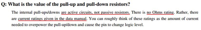

As the " General Purpose IO (GPIO) FAQ for C2000" says:

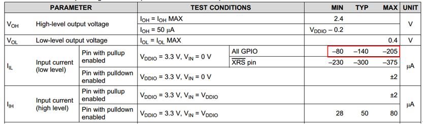

The datasheet says:
So, in the stage①,I=0.086V/660Ω=130uA, 330Ω、100Ωalso like this.
But, in the stage③,when gpio output 1, what causes the voltage to fall,and the current isn't in range.

How to understand the recommended operating conditions 4mA?

    The Recommended operating conditions table is a list of conditions you should not exceed, if you do the information in the datasheet will no longer be valid.
    The device 'can', BUT IT SHOULD NOT, source more than 4mA. If you supply a few hundred mAs through a pin it has been damaged. The effects may not prevent the device from functioning but some damage has occurred. If you continue to source or sink too much current the IO buffer will stop working.

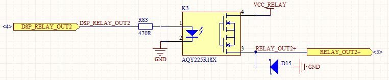

    If I want to control a photo-mos relay,could it be achieved without another transistor or MOS?

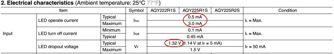

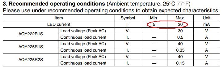

    The photo-mos relay is AQY225R1SX from Panasonic,the LED turn on current is 0.5-3mA,the LED continuous operating current is 5-30mA.
    But DSP source or sink current is 4mA(Other some 8mA pins are not considered).It is possible the photo-mos relay can continuous operating with 4mA,but at the critical condition,what is your opinion?
    Besides,should I use high level or low level to drive? Because I don't want photo-mos relay open at stage①.I tried a test like this:

  • LC,
    you will need to use an LED driver if the current exceeds 4mA.
    As a general rule its better to sink current rather than source current, so "1.low drive level" is more common. You'll have to determine which  method is better for the behavior you want.
