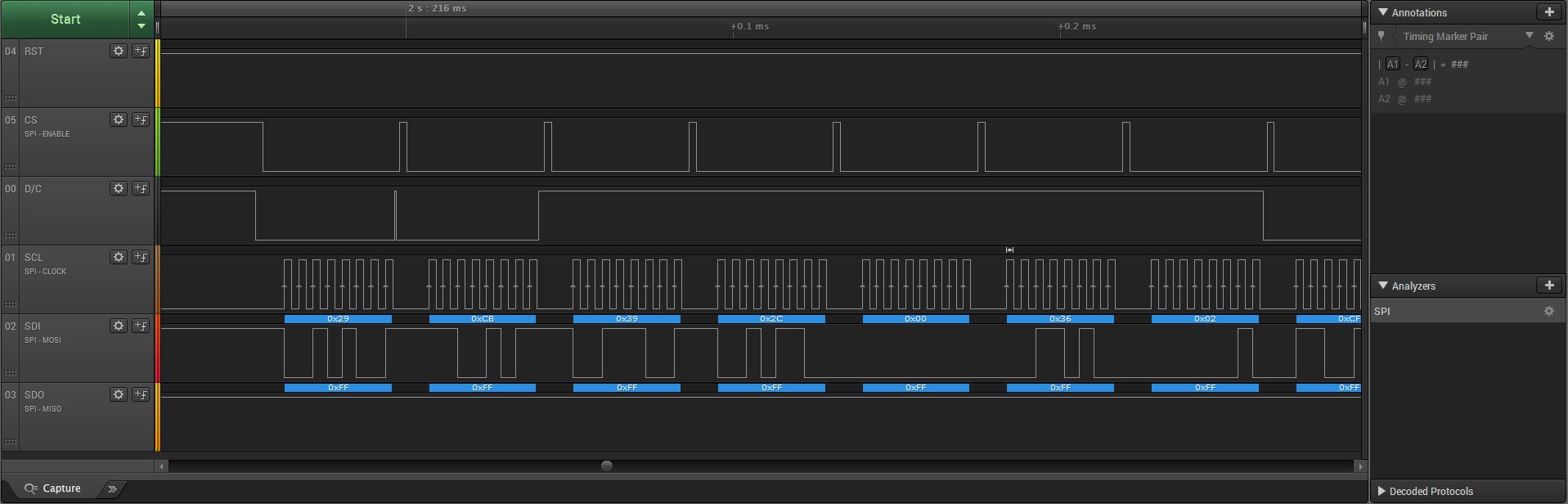

I have the following ili9341 lcd
The display is connected as described:
 * ILI9341 <--> LAUNCHXL-F28069M interconnect
 * ILI9341		LAUNCHXL-F28069M				InitSpiaGpio
 * SDO(MISO)	J2(14)	1SPI_SO		(GPIO17)	(SPISOMIA)
 * LED			J4(34)	GPIO		(GPIO13)
 * SCK			J1(7)	1SPI_CLK	(GPIO18)	(SPICLKA)
 * SDI(MOSI)	J2(15)	1SPI_SI		(GPIO16)	(SPISIMOA)
 * DC			J2(18)	GPIO		(GPIO44)
 * RESET		J1(8)	GPIO		(GPIO22)
 * CS			J2(19)	1SPI_CS		(GPIO19)	(SPISTEA)
 * GND
 * VCC
I have the following code to drive the LCD:

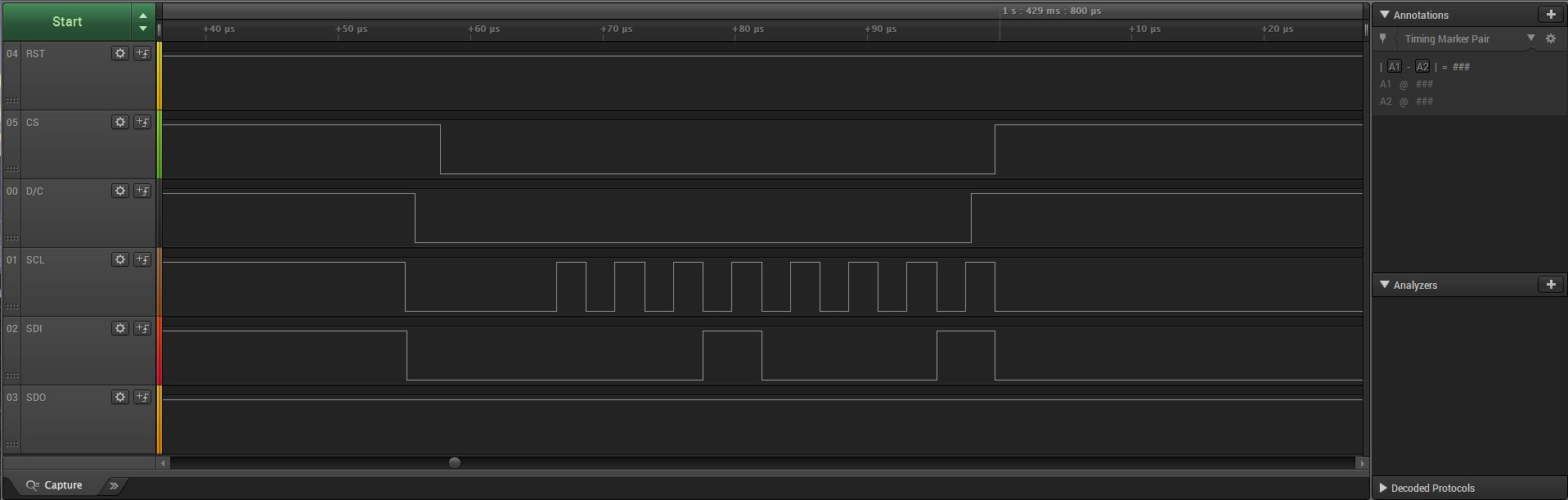

The waveforms SPI_WR looks thus:

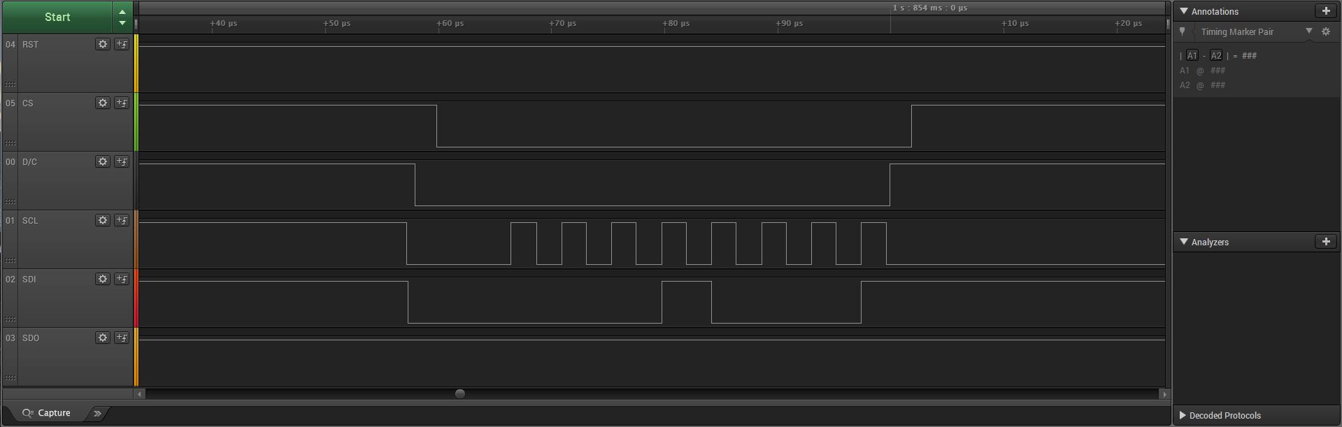

and the SPIWR16 looks thus:
I've been expecting the display to be filled with GREEN, but display seems void of anything:
The display is actually white, but the camera makes the LCD appear bluish.

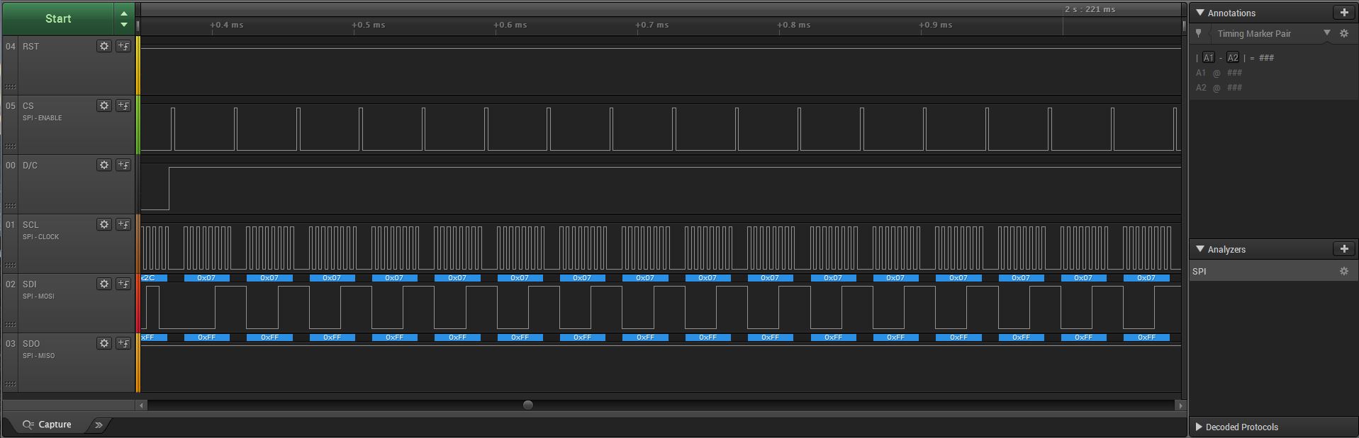

Given that nothing is visible on the display that I've written to it, but when the SPI Clk Phase is changed from
    SpiaRegs.SPICTL.bit.CLK_PHASE = 0;        /* CPHA = 0, normal mode            */
to
    SpiaRegs.SPICTL.bit.CLK_PHASE = 1;        /* SPICLK delayed by one half-cycle          */
Now the display appears thus:
I wonder whether anything is wrong with my spi writes. If not, wondering what else could be wrong ? Though the window area which is filled is not as expected, the color is exactly what was expected. The LCD command/data sequence has been working exactly as expected on a STM32 Cortex M3 previously.
Also the ILI9341 SDO line should be sending the data back to the Master ? But can't see that either ?
The ILI9341 appears to use a Normal CLK Phase, but the display doesn't seem to like that; Unless there is an issue with my SPI writes.
I am slightly lost here. Can someone help, please ?
Manu

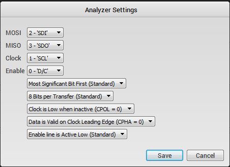

  • Forgot to mention the following:
    When
    SpiaRegs.SPICCR.bit.CLKPOLARITY = 0; /* CPOL = 0 */
    SpiaRegs.SPICTL.bit.CLK_PHASE = 1; /* CPHA = 1 */
    The logic analyzer fails to decode the bytes when the analyzer is set to CPOL=0, CPHA=1, but it does decodes when CPOL=0, CPHA=0
    likewise when
    The logic analyzer fails to decode the bytes when the analyzer is set to CPOL=0, CPHA=0, but it does decodes when CPOL=0, CPHA=1
    It felt a bit weird to me that probably the CPHA bit is inverted in contrast to what's stated in the TRM ? Then a quick thought was that probably the Analyzer could be buggy, but then the ILI9341 also behaved exactly the same way as the Analyzer. Quite confused though ..

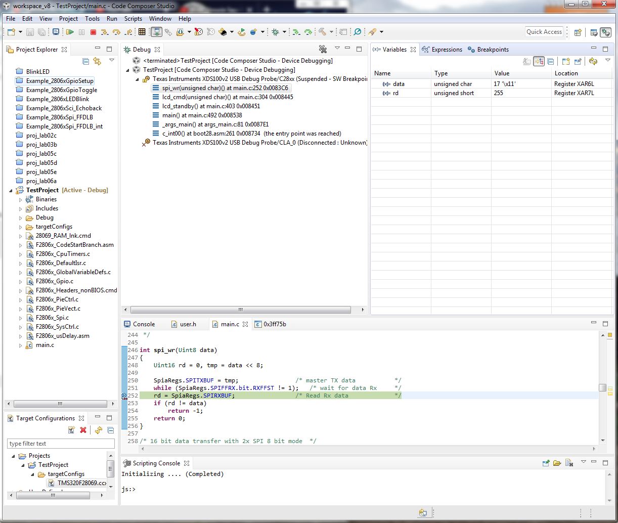

  • Update:
    Found an issue in spi_wr16(Uint16 data). The read back from the Slave is 0xff in all situations, as can be verified from the logic analyzer waveform. As a result, the second spi_wr() fails to execute. Commenting out the rd != tmp comparison check does fix temporarily spi_wr16().
    Still the SPI peripheral needs to be initialized with
    Still wondering why the SPI reads are all 0xff's. The display seems to display the data what's written to it though.

    It results in the following waveform:
    Now in init_spi()
    is changed to
    SpiaRegs.SPICTL.bit.CLK_PHASE = 1;		/* CPHA = 1, SPICLK signal delayed by one half-cycle		*/
    which results in the following waveform:
    Hmm.. The SPI_CLK is indeed delayed by one-half cycle, as per register definitions according to the TRM. The LCD likes CPOL=0,CPHA=1. Looking at the
    LCD datasheet again, on Page 35, the waveform describes CPOL=0, CPHA=1, AFAICT. The only odd man out is the Analyzer's SPI packet decoder,
    which seemingly interprets the waveform, the other way around.
    AFAICS, there exists no issue on the SPI CPHA bit inversion; Sorry about the noise, maybe I should've double cross checked earlier.
    Sorry about this unnecessary noise.

    Manu

    The logic analyzer may not be decoding properly due to the clocking phase and polarity scheme between the devices. Our polarity and phase bit settings don’t necessarily match what other devices have. That being said, try to match the configuration, not the bit setting (i.e. transmit on rising, receive latch on falling edge).
    Please let me know if you are still not able to resolve your issues.
    Marlyn

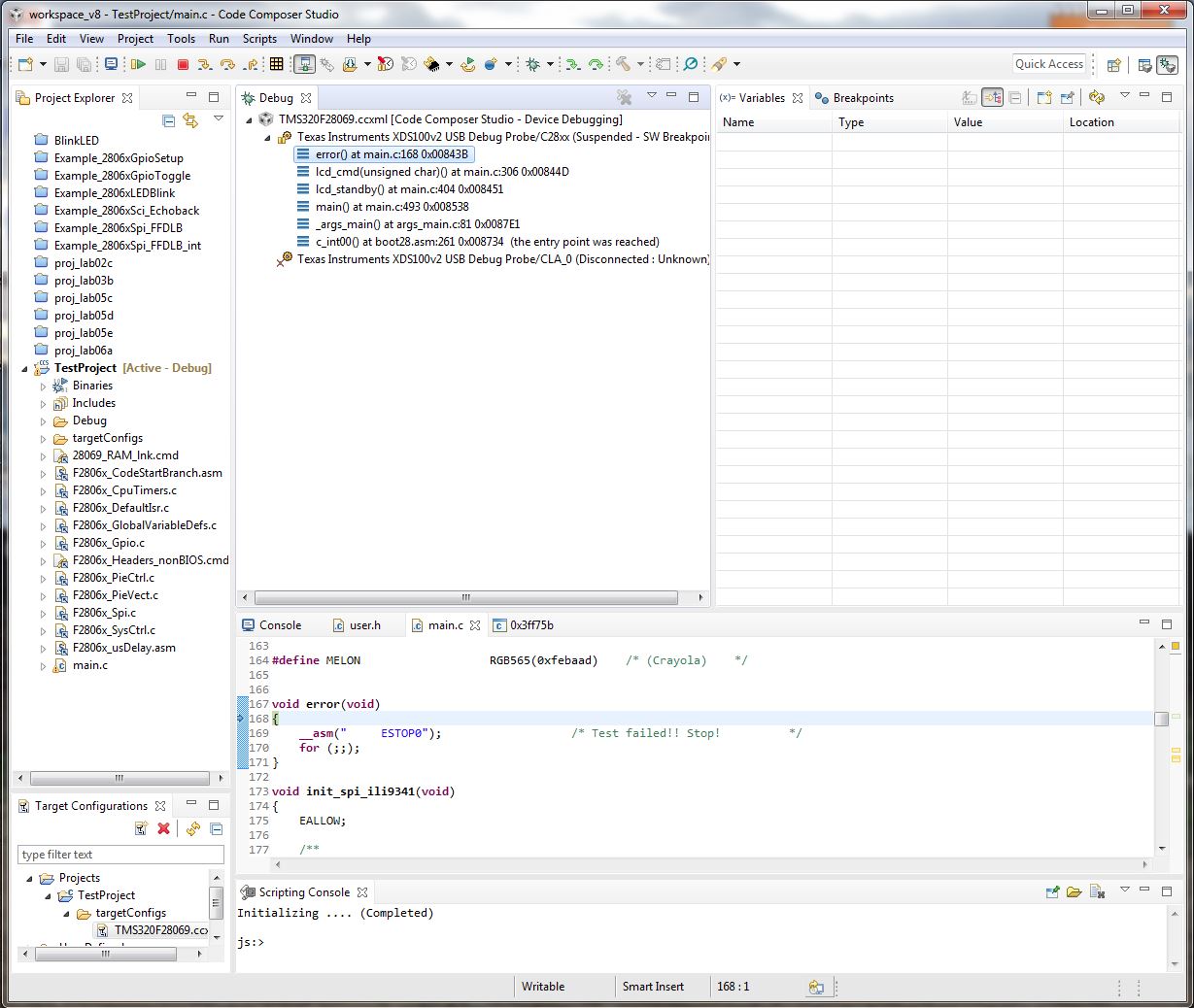

    adjusted lcd_cmd() to check the situation:
    void error(void)
    	__asm("     ESTOP0");					/* Test failed!! Stop!			*/
    	for (;;);
    void lcd_cmd(Uint8 cmd)
    	 * D/CX bit is “low”, the transmission byte is interpreted
    	 * as a command byte.
    	GpioDataRegs.GPBCLEAR.bit.GPIO44 = 1;	/* pull down D/C pin		*/
    	if (spi_wr(cmd) < 0)
    		error();
    	GpioDataRegs.GPBSET.bit.GPIO44 = 1;		/* pull up D/C pin			*/
    The very first time spi_wr() is executed, execution stops if rd != data; and it did stop.

    Regarding the Analyzer, what I meant to say is that SPI decoder with it is buggy; It does have an option to setup CPOL and CPHA as per requirements. But the buggy situation lands in a situation where when CHPA=0 on the F28069, needs a CPHA=1 setting on the analyzer and vice versa when CPHA=1 on the F28069.
    The Analyzer thing is a non issue, it's a bug within the Analyzer's SPI decoder, AFAICS. It took some time for me to realize that issue. Sorry that I did not cross check each situation.

  • Hi Marlyn,
    I tried to debug what rd and data really contains, to make more sense of the issue.
    void lcd_standby(void)
    	lcd_cmd(LCD_SLEEP_OUT);					/* 0x11						*/
    	DELAY_US(150000);						/* Wait 150mS				*/
    	lcd_cmd(LCD_DISPLAY_ON);				/* 0x29						*/
    I do see that data = 17 (0x11), rd = 255 (0xff); Attached screenshot:
    Irrespective of what operation is done, the readback value is 0xff, which is exactly what's seen in the Analyzer waveform. As I wrote in my first post, I don't understand why the Slave Data Output (SDO) is Low all the time. Attaching the previously Analyzer waveform again:
    Manu
