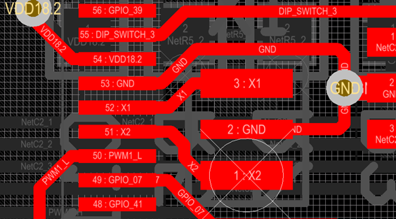

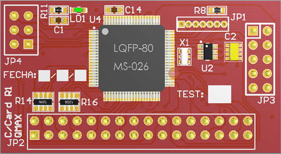

    Could you please share the schematics/layout of the circuitry around the resonator?
    Would you be able to put a number on the occurrence of failure? i.e. Oscillator doesn’t work x out of y attempts.
  • Hi Hareesh,
                        Thank you for your rapid response. As you requested this is my application data.
    This is our 4 layer PCB top view using the TMS320F28035
    A zoom of the Resonator
    A view of the top Layer PCB

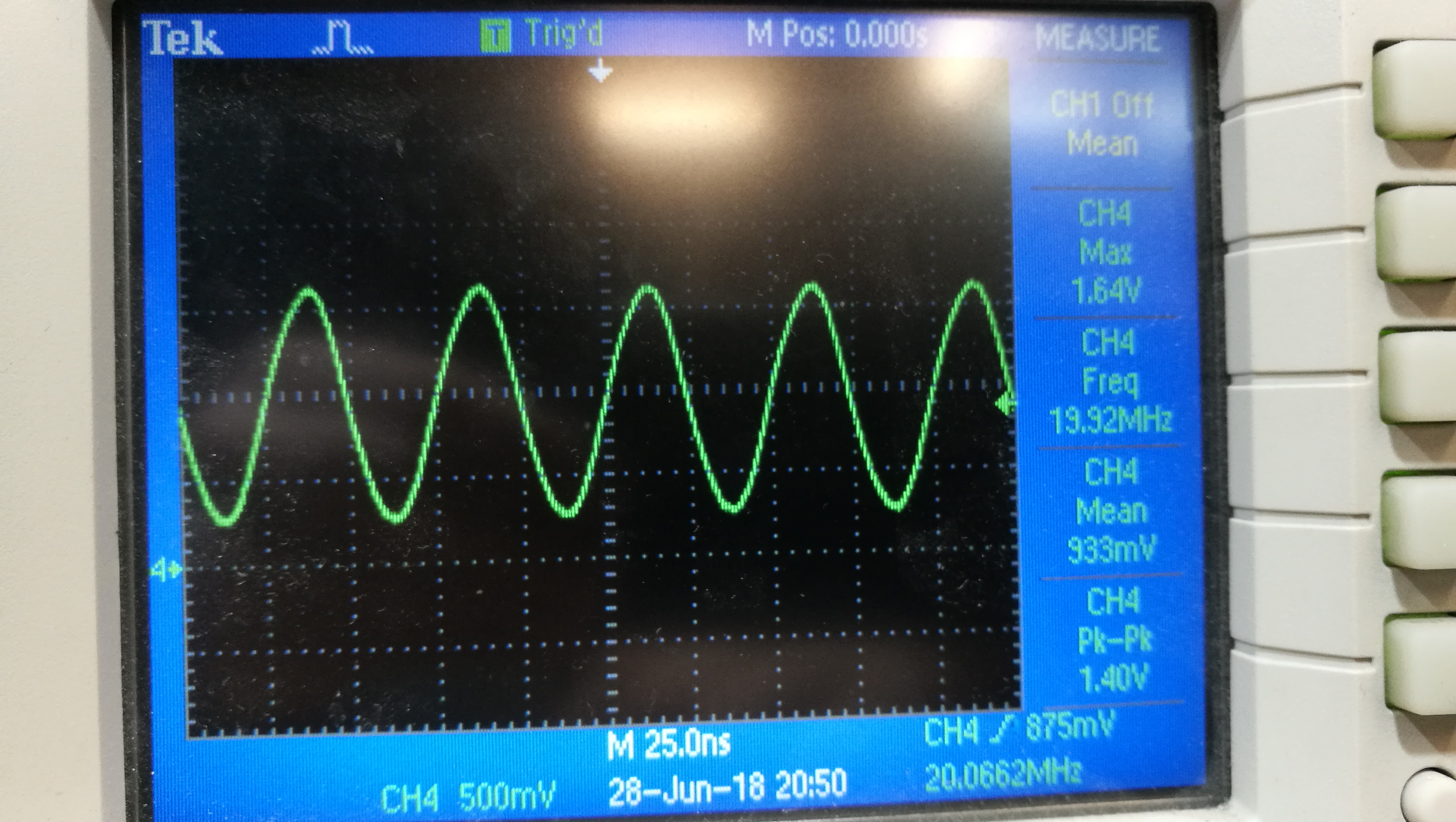

    Screen capture of the Oscilloscope measuring X1 signal
    The only way I managed to start with the resonator is first flashing the Micro with a code that uses the internal oscillator. And after that I flash again a new program that uses the external Xtal. But if I power down the board and power up again, it doesn’t start. When the board isn’t working the signal on the X1 is what I showed.

  • The fact that it only fails sometimes tells me that s/w is unlikely to be the cause of the problem. You have not answered my question: Would you be able to put a number on the occurrence of failure? i.e. Oscillator doesn’t work x out of y attempts. Please answer the questions below carefully:
    1. You are saying even when the system does not work, you still see the oscillations in X1/X2 pins. How did you determine it is "not working"?
