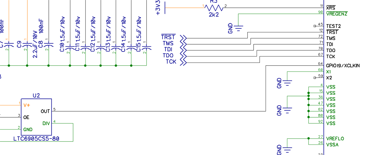

Using a modified Lab06a, I'm struggling to setup the use of an external clock source on GPIO 19. All my efforts so far have left with an unstable application: i.e. random Illegal ISRs or lockups. Can anyone suggest whats going wrong?...
Code has been modified in two areas:
HAL_SetupClks()
    //configure clkin pin as GP
    GPIO_setMode(obj->gpioHandle, PIN_XCLK_IN, GPIO_MODE_GENERAL_PURPOSE);
    GPIO_setDirection(obj->gpioHandle, PIN_XCLK_IN, GPIO_Direction_Input);
    //enable the clk-in pin
    CLK_setXClkInSrc(obj->clkHandle, CLK_XClkInSrc_Gpio19);
    CLK_enableClkIn(obj->clkHandle);
    // set the oscillator source
    CLK_setOscSrc(obj->clkHandle, CLK_OscSrc_External);
    // disable the crystal oscillator
    CLK_disableCrystalOsc(obj->clkHandle);
    // disable oscillator 2
    CLK_disableOsc2(obj->clkHandle);
    // set the low speed clock prescaler
    CLK_setLowSpdPreScaler(obj->clkHandle, CLK_LowSpdPreScaler_SysClkOut_by_1);
    // set the clock out prescaler
    CLK_setClkOutPreScaler(obj->clkHandle, CLK_ClkOutPreScaler_SysClkOut_by_1);
Then the HAL_setupPLL() function keeps the PLL at div/4
PLL_setDivideSelect(obj->pllHandle, PLL_DivideSelect_ClkIn_by_4);
The clock source I'm using is a 20MHz silicon oscillator, connected to GPIO19. Scoping the clock source shows its 'ok' - no major noise or deviations.
Any ideas?

  • 0x40 does not imply “PLL clock missing”. Could you please provide the correct 16-bit value of PLLSTS register? Can you provide a scope shot of the clock at GPIO19? Are you able to run a C2000ware example “as is” with the external clock? You could pick a CPU-Timer example.
    • Is the X1 pin tied to GND?
    • Could you provide the schematics of your design? Not the whole thing, just the parts connected to X1/X2 & XCLKIN pins.

  • Hi Hareesh,
    Running the C2000Ware example 'as is' isn't straight forward due to the custom board and motorware support. However, I've got some new oscillators on order: so I can try two things:
    1. Connect 20MHz to the Launchpad, running example code
    2. Connect 10MHz to our board, running motorware, etc.
    I will also send you the full register info: alas I've run out of time today to do this!
    Schematic snippet below.
    Mat
