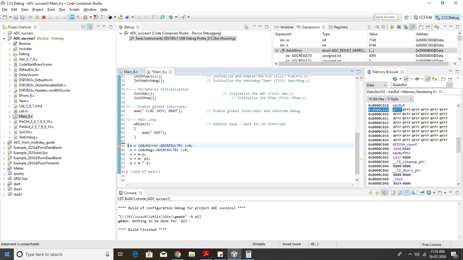

  • I have followed all the steps. Its working fine with simple programs like addition. But I am unable to store the ADC results value. I have taken
    m = AdcMirror.ADCRESULT0;
    n = AdcRegs.ADCRESULT0;
    Mirror and AdcRegs value are showing correct results but m & n values are showing incorrectly. I am attaching a snapshot with this.
  • Soumya,
    It looks like the while(1) loop in main() will not allow your m and n assignments to execute. That could be the reason for the warning on line 48.
    Also, the value of AdcMirror does not need to be shifted as it is already done in hardware.
    -Tommy

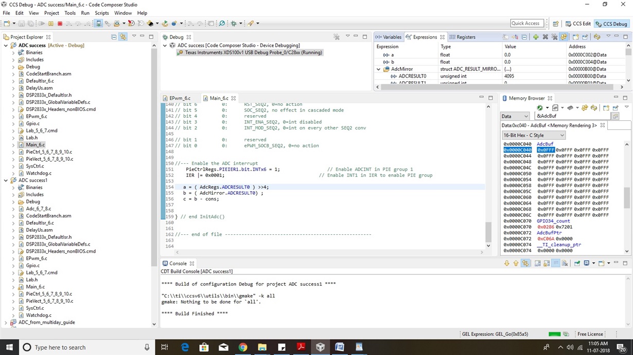

  • Please suggest me the solution. Here is another screenshot without any warning. Though the mirror result0 value showing correctly, the variable a and b are incorrect. Please help me to make the proper way to see the result in a variable so that I can do the mathematical operation with the Adc result.
    Its better to check the ADCINT flash before fetching results. Something like this:
    while(1)
      while(AdcRegs.ADCINTFLG.bit.ADCINT1 == 0){}
      AdcRegs.ADCINTFLGCLR.bit.ADCINT1 = 1; 				//Clear ADCINT1
      a = AdcResult.ADCRESULT0;
    Please do refer: C:\ti\controlSUITE\device_support\f2833x\v142\DSP2833x_examples_ccsv5\adc_soc
    Gautam

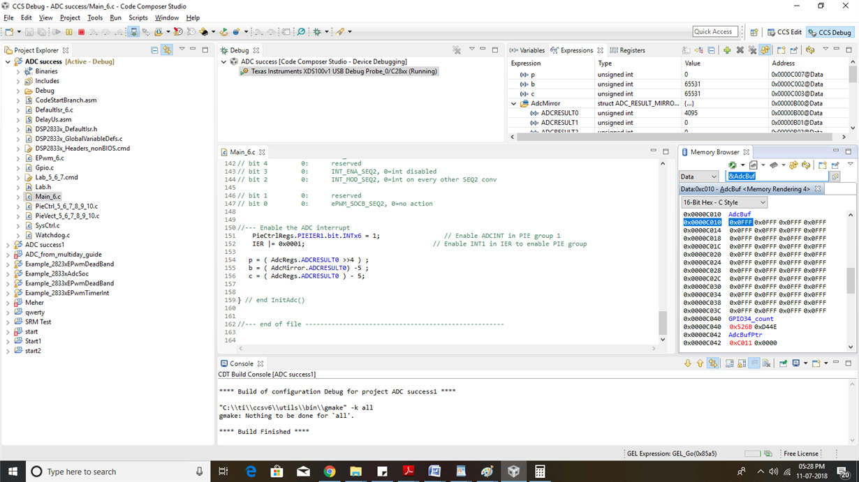

  • Sir, I have marked one more thing,  that whenever I am subtracting an integer from the ADC result value (say 5), then the result is 65531. (65536-5=65531). 65536 in decimal is equal to 1 0000 in HEX. So, is there any problem regarding 16 bit or 32 bit?
    Another point is, The result remains the same (65531) while ADC A0 pin is connected to 3V3 or GND. I have attached some screenshots with this for reference.
    While connecting to 3v3
    While connecting to GND,
  • Soumya,
    It almost looks as if you are trying to read the results before the ADC is triggered?
    Have you tried running an unmodified ADC example from controlSUITE or C2000Ware? I recommend that you start from a working example and then slowly make edits in your own copy with frequent builds to make sure that everything is working as expected.
    -Tommy
