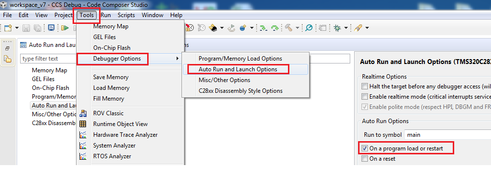

  • I am assigning GS RAMs to CPU2 in CPU1 code after the main() is called and all CPU1 clocks are initialized.  I am booting CPU2 from CPU1 by using the IPC Boot Mode command C1C2_BROM_BOOTMODE_BOOT_FROM_FLASH in the CPU1 code well after GS RAMs are assigned to CPU2.
    I am testing this with debugger by loading cpu1 and cpu2 codes, starting the cpu1 execution, and then starting cpu2 execution.
    Follow up question:  Does the c_int00 is executed when binary image is loaded in debugger but not started?  If answer is yes, then this explains why cpu2 code initialized variables are not getting initialized.  Is there a work around so that c_int00 is not executed on loading the binary file in debugger?
    Zubair
  • Hi Zubair,
    Yes. When you load symbols to a target CPU, the debugger will execute c_int00 and then break or stop at main().
    1) If you run your application from standalone it should work.
    2) If you connect and load CPU1 and run the code to give CPU2 access to the GS RAM, and then connect and load CPU2, the it should work as well.
    sal
  • Also other option is to uncheck the default setting of "RUN to symbol Main" option in CCS (uncheck the so that c_int00 function does not run after code is loaded on CPU2.
    Vivek Singh
  • This solves my issue. Thank you very much for your help.
