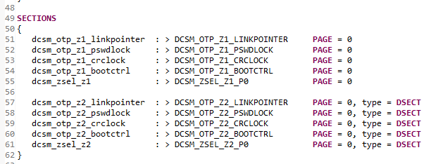

I try to change the bootpins for flashboot at the µC.
Therefore I use the blinky_with_dcsm example from controlsuite. I change in the projectproperitys the mode to flash and added followed linker files (folder cmd):
in the asm file I uncommendet all .longs exept the reversed, because when I uncommend the reversed I get an error at flashing the µC:
in the bootctrl section I changed the pins to GPIO50 and GPIO51 (line 84). When I tried this in the on-chip-flash settings in the debugger mode of ccs it works fine
(I have some controllers to do such tests).
In the dcsm linkefile I deleted ", type=DSECT" of zone 1:
I can flash the controller with this settings but when I put power of and power on the µC just boot with 1 at GPIO 72 and GPIO 84.
What i did wrong?
