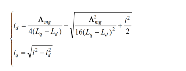

  • In instaSPIN-FOC, you could run IPM like SPM, just set Ld&Lq in user.h, not only Ls. There is no verified MPTA algorithm to be released in InstaSPIN till now. You might select a correct algorithm based on your system. Many research papers could be found on IEEE or other websites. Below is a generic algorithm, the "i" is the output of the speed regulator.
