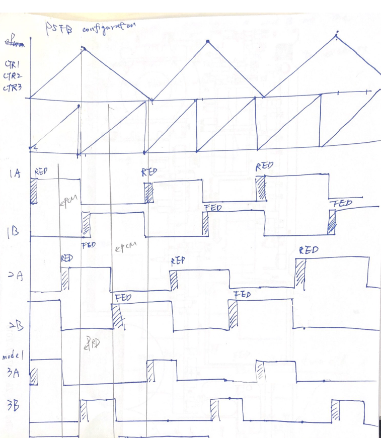

Dear C2000 expert
We are trying to use CMPSS to provide CTRIP signal in order to generate the T1 /T2 event.
The CTRIPH was selected as CTRIP_FILTER

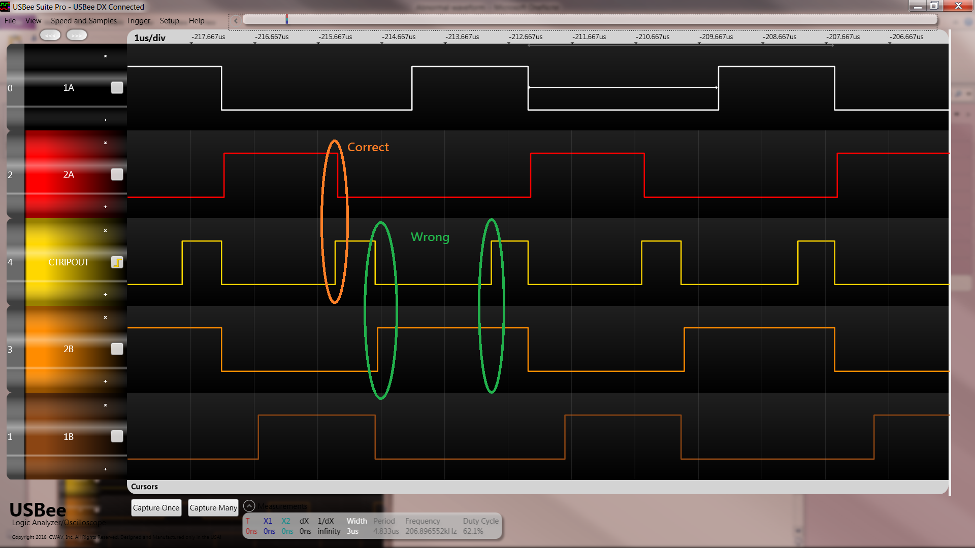

Generally the output was look good.The 2A/2B was turn on / turn off at the T1 event  (T1D/ T1U)
When we put the configuration at close loop to do PSFB control , we fund the 2A/2B signal was shoot through.
We look at the EPWM open loop and we fund  such wrong was impacted by CTRIP signal waveform.
The B channel wil work not correctly and get crasy.
We try to simplize the issue. We set PWMA and PWMB channel was all the same configuration and the dead time set to zero.
We the the PWMB signal was becoming uncontrollable when the T1 event was triggered.
PWMB was change the state after the CTRIP sinal was low. We also fund the PWM module was getting uncontrollable until we disable the T1 event.
I didnot know why the PWMB signal become unexpected waveform.
We also find the strange behavior when we  try to change the OUTSWAP(DB module) to verify the PWMA and PWMB at this kind of condition.
The OUTSWAP( DB module) was not follow the value we changed until we disable the T1 event source.

    I capture the waveform from F280049 control card. If you want to look it  , i would prepare how  i setup it.

  • Brian,
    Looking through your code and the wave forms above,
    From the wave forms - it seemed like you want have active high complimentary outputs.
    Is this correct?
    So, in the PWM configuration I see -
    EPwm2Regs.DBCTL.bit.IN_MODE = DBA_RED_DBB_FED;
    Did you want to have both outputs A/B generated out of A in Active high complimentary mode?
    if so, you need to make it
    EPwm2Regs.DBCTL.bit.IN_MODE = DBB_ALL;
  • No not complimentary more.
    Both A/ B need rising edge dead time. The timing diagram was as bellowing
    We fund this issue first time when we change the CTRIPH to latch signal from the signal after digital filter.
    The B channel will be wrong behavior. it look like PWMB change the output after the CTRIPH was reset.
    Today , i try to change EPWM3A  as same configuration as EPWM2B.
    At the same testing condition , it look like workable and  did not have such fault.
    However , the solution would lead  us to occupy more ePWM  module.
    BR
    Brian Chang
  • Brian,
    Your diagram seems to indicate EPWM1/2 outputs as active high complimentary.
    PWM1/2B is complimentary and inverted version of PWM1/2A.
    So, i still think that you should be using EPwm2Regs.DBCTL.bit.IN_MODE = DBB_ALL;
    Maybe i'm misunderstanding the requirement here.
    Are you saying that your application works if you use EPWM3A instead of EPWM2B - though they are with same configuration?
