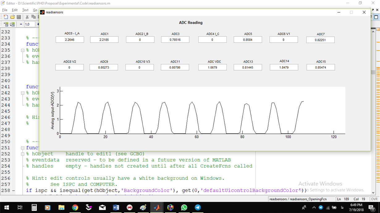

I work with a TMS320F28335 DSP board and CCS 3.3. I read 16 ADCs and transfer data to Matlab GUI and Simulink 2012a in order to be analyzed. The problem is that it seems the ADC sample time is not sufficient or it didn't set properly.
The following picture shows ADC0 that had to be a sinusoidal waveform. The second picture shows settings in Matlab/Simulink.  When I had only one ADC the data were more smooth and more similar to a sinusoidal waveform.
I'll appreciate if someone guides me on how can I have a more smooth waveform.

  • Abolfazl,
    Thanks for reaching out to the E2E forum. From the pictures it looks like you have enabled simultaneous sampling; this will effectively half your sample rate on a given channel(it increases the throughput overall for the system). Can you describe your input/system a bit more; for example how many physical analog inputs do you have coming into the F2833x MCU? We also need to see how the MAXCONV is being set up by the GUI, as that can make alot of difference in the effective sample rate.

  • Thank you MatthewPate for your respons.
    I wrapped the connecting cables with Aliminium sheets and the response is a little bit better (because of noise cansellation). But the sampling rate problem is not fixed yet. If I want to explane my work here I can say I'm reading data with ADC channels. Using a GUI interdace I transfer them from CCS to Matlab . Then Using "set_param" command I transfer them to my model in Simulink.
    I'm reading all 16 ADCs that contains 4 voltages, 3 currents, 2 torques, ... . I enabled simulataneous sampling. Since I'm not much familiar with this issue, I copy here all codes that generated with Matlab that exist in "c28xx_csl.c", "c28xx_board.c ","c28xx_adc.c","main.c " and "test.c" files.

  • Abolfazl,
    For best speed, we need to make sure the ADC Clock is 25MHz and ACQPS = 0.  The current setting for ACQPS = 4, so that can be changed to 0 easily.
    Determining the ADC clock will be a bit more involved; there are 2 fields you are showing, the CPS bit and the ADCCLKPS bits.  However, we also need to know the HSPCLK divider.  This register is located in the system control space, with the PLL.  In most cases, HSPCLK is set to 3(which gives a div by 6) and that will give 25MHz to the ADC.  In this case you can then zero out the ADCCLKPS and CPS bits.
    Due to the pipeline architecture of the ADC on this device, any time we start/stop the ADC we absorb a cycle hit until the ADC is converting continuously.  So, I would recommend setting the cont run bit for best throughput if possible, else you will absorb an additional 40ns for each run(which may be OK for your system)
    At any rate the sample timings for your use case are listed here :http://www.ti.com/product/TMS320F28335/datasheet/specifications#sprs2301242
    If we keep the ADC loaded, then you should get 2 results every 120ns, or 16.67MSPS.  If I further define this as the sample rate of each input(since you are using all 16) then each signal will be sampled at ~1.04MSPS
    Matthew
  • Dear Matthew,
    Thank you for your comprehensive response. I changed the  ACQPS to zero but it didn't make any difference.
    Now I think maybe the problem is because of RTDX. As I read in " " RTDX is available on XDS510 and XDS560 class of emulators but I have a TMS320F28335 Experimenter Kit with XDS100 emulator. Do you have any idea about it?
    Bests,
    Abolfazl
  • Abolfazl,
    While the comment on RTDX support by emulator is correct, I'm not certain that block is being used. I say this because you are getting ADC data inside of simulink. I'm going to get some more folks looking at this who are more simulink savvy than myself.
    Matt
