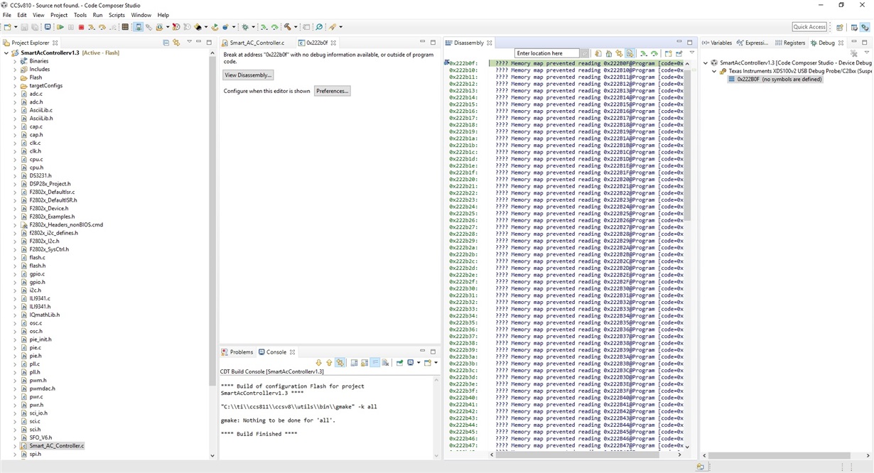

???? Memory map prevented reading 0x222B0F@Program [code=0x20000]
Part Number: TMS320F28027
When I debugging my code and calling function "GPIO_setDirection(myGpio, GPIO_Number_29, GPIO_Direction_Output);" getting an error " 0x222b0f:     ???? Memory map prevented reading 0x222B0F@Program [code=0x20000]" I tried all tread in the forum and nun of them not working for me. My code was working fine i did some changes in i2c function i faced this issue. Even i removed it doesn't back to normal. I have changed heap and stack to 0x400 that also not working for me. Pleas help to solve this issue.
CCS v8.1.0
few lines of my code
void main(void)
// delay_ms(100);
init_variables();
init_pheripharals();// Initialize all the handles needed for this application
init_system(); // Perform basic system initialization
// LCD_ILI9341_init();
Config_gpio();
CLK_enableI2cClock(myClk);// enable I2C CLK
GPIO_setMode(myGpio, GPIO_Number_32, GPIO_32_Mode_SDAA); //Pin J2.6 of Launchpad is used for SDA
GPIO_setMode(myGpio,GPIO_Number_33,GPIO_33_Mode_SCLA); //Pin J2.7 of Launchpad is SCL
init_i2c();
Config_adc();
Config_timers();
GPIO_setDirection(myGpio, GPIO_Number_29, GPIO_Direction_Output);   // here i am getting error
GPIO_setDirection(myGpio, GPIO_Number_17, GPIO_Direction_Output);
LCD_ILI9341_init();
