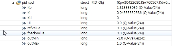

I'd like to tune speed PID parameters of my custom code based on motorware.
I have changed Kp and Ki at CTRL_setParams() as follows
  // set the default speed PID controller parameters
//  Kp = _IQ(0.02*pUserParams->maxCurrent*pUserParams->iqFullScaleFreq_Hz/pUserParams->iqFullScaleCurrent_A);
//  Ki = _IQ(2.0*pUserParams->maxCurrent*pUserParams->iqFullScaleFreq_Hz*pUserParams->ctrlPeriod_sec/pUserParams->iqFullScaleCurrent_A);
  Kp = _IQ(0.035*pUserParams->maxCurrent*pUserParams->iqFullScaleFreq_Hz/pUserParams->iqFullScaleCurrent_A);
  Ki = _IQ(2.5*pUserParams->maxCurrent*pUserParams->iqFullScaleFreq_Hz*pUserParams->ctrlPeriod_sec/pUserParams->iqFullScaleCurrent_A);
  Kd = _IQ(0.0);
  outMin = _IQ(-1.0);
  outMax = _IQ(1.0);
  PID_setGains(obj->pidHandle_spd,Kp,Ki,Kd);
  PID_setUi(obj->pidHandle_spd,_IQ(0.0));
  PID_setMinMax(obj->pidHandle_spd,outMin,outMax);
  CTRL_setGains(handle,CTRL_Type_PID_spd,Kp,Ki,Kd);
I could see Kp and Ki was updarted as I intended at start as following capture.
After I ran the motor, it was restored as original value.
I could not find which code was update the Kp, Ki value.
so I could not test tunned parameter of speed PID.
Would you please let me know how to update Kp, Ki value of speed PID ?
Thanks in advance
  • I assume your reference project is lab05b or lab10a. The Kp and Ki of speed/current will be updated by calling updateKpKiGains(), so you may only change gMotorVars.Kp_spd and gMotorVars.Ki_spd to tune the speed loop. More detail is as below just for your reference.
    The new Kp and Ki of speed and current loop will be set in CTRL_updateState() which is called in background loop like below code.
    // update the controller state
    bool flag_ctrlStateChanged = CTRL_updateState(ctrlHandle);
    And you might find below code in CTRL_updateState(), but the CTRL_setupEstOnLineState() is in ROM that update Kp and Ki for both speed and current loop.
    if(EST_isOnLine(obj->estHandle))
    // setup the estimator for online state
    CTRL_setupEstOnLineState(handle);
