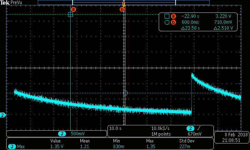

Hi ,
I measured tooth wave 0.1-- 1.35Volt , Period of 60-100 seconds on several 28335 DSPs  ADCREFP output.
The issue occurred after 1 day of operation in one case  and  after 60 days in another .
The software is Ok.
ADCREFIN was floated on this revision of PCBs.  ADCREFIN connecting to AGND with wire not helps.
Please advise.

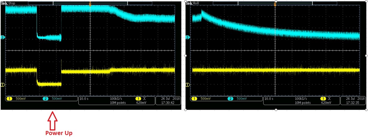

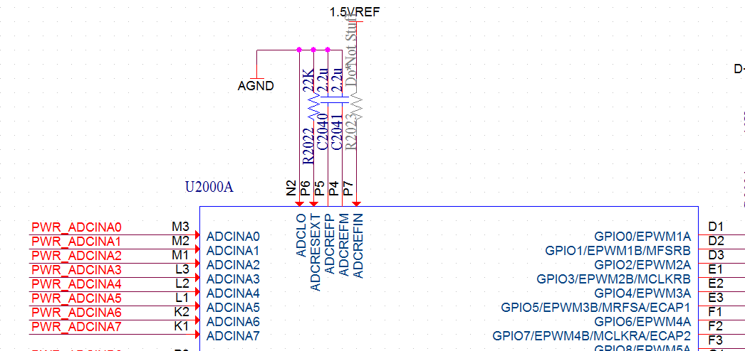

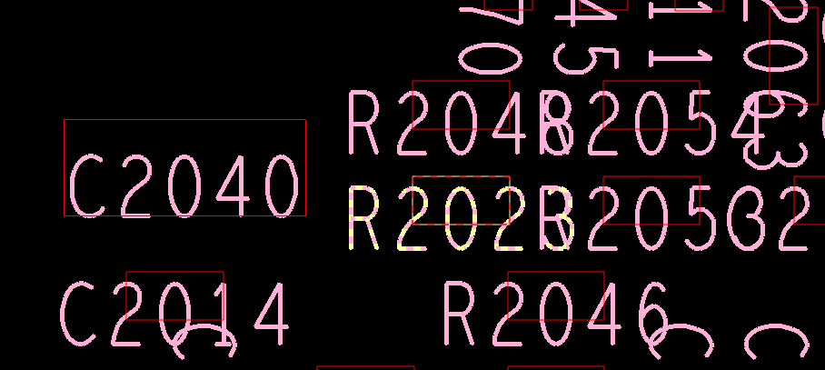

    Attached is the signal they see using an opscilloscope when this pin is floating plus partial schematic portion and the PCB layout in this section.
    Please advise them how to check why the ADC is still no0t working and what can be the long term impact of leaving the ADCREFIN floating as they did.

    I just want to clarify one point:
    1)ADCREFIN currently is floating
    2)ADCRESEXT connected with 22kOhm resistor to ground.
    Please confirm the above.
    While it is best practice to tie unused ADCREFIN to ground, I do not believe floating the pin would cause this kind of issue.
    Can you also measure ADCREFM signal and note its behavior? On a scope both ADCREFP/ADCREFM should look very DC in nature; around 2V and 1V respectively.

    Looking at the waveform we can see that ADCREFP begins to ramp up, then discharges over time.
    I think we may be looking at a symptom(rather than the root cause) of a system issue. I would suggest we put another scope probe on XRSn and see its behavior with ADCREFP. My theory is that the code on the MCU begins to run/initialize and is somehow interrupted/stopped by an XRSn event and we start over again.
    Given the size of the cap on ADCREFP this behavior is one I would expect if the enable bit inside the ADC registers is disabled. If possible I would connect an emulator to the device and enable the ADC manually (or run through the ADC setup code and halt), and see if the problem on ADCREFP goes away.
    Assuming both the above are true then we can debug the true root cause of the issue, again I suspect the device going into reset caused by something external.
    Finally, while the datasheet recommendation is to tie ADCREFIN to ground this is more a best practice to not float an unused pin for ESD reasons, etc. Certainly there is an increase in likelyhood an ESD event could could cause and over/under-voltage on this pin if it is floating, in which case there can be unpredictable damage. However, based on the behavior shown in the scope plots I can't conclude that is the root cause at this time.

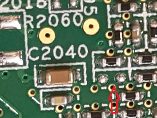

  • Hi , Matthew,Ariel
    ADCREFP and ADCREFM, looks like 2.2uF discharge via TPP0500B oscilloscope probe (10M).  Pressing  CPU case can restore the ADCREFP signal ( ADC still displays wrong results). So , it looks like cold solder contact , some capacitors crack , wirebond disconnect or similar.   Will check this next week.
    Thank you,
    Michael
  • Hi. Finally it was single ferrite bead to VDD1A18 and VDD2A18 microcrack (in 2 boards) . Pressing on CPU caused PCB deformation and restored ADCREFP . Bypassing of ferrite solved problem. . Than you , Michael
