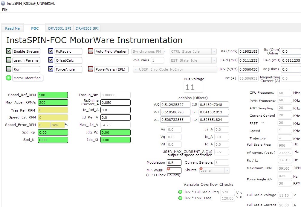

    I have since run lab5b and after I ran the Identification I tried to adjust the Speed_Ref_RPM. The motor tried to start spinning; however, it stopped after a very short time (Different motion produced from Simulink example).
    I have run Lab02c and have tried to save my parameters into the User.h file and run Lab5b; however, I am still having the same issue as before.

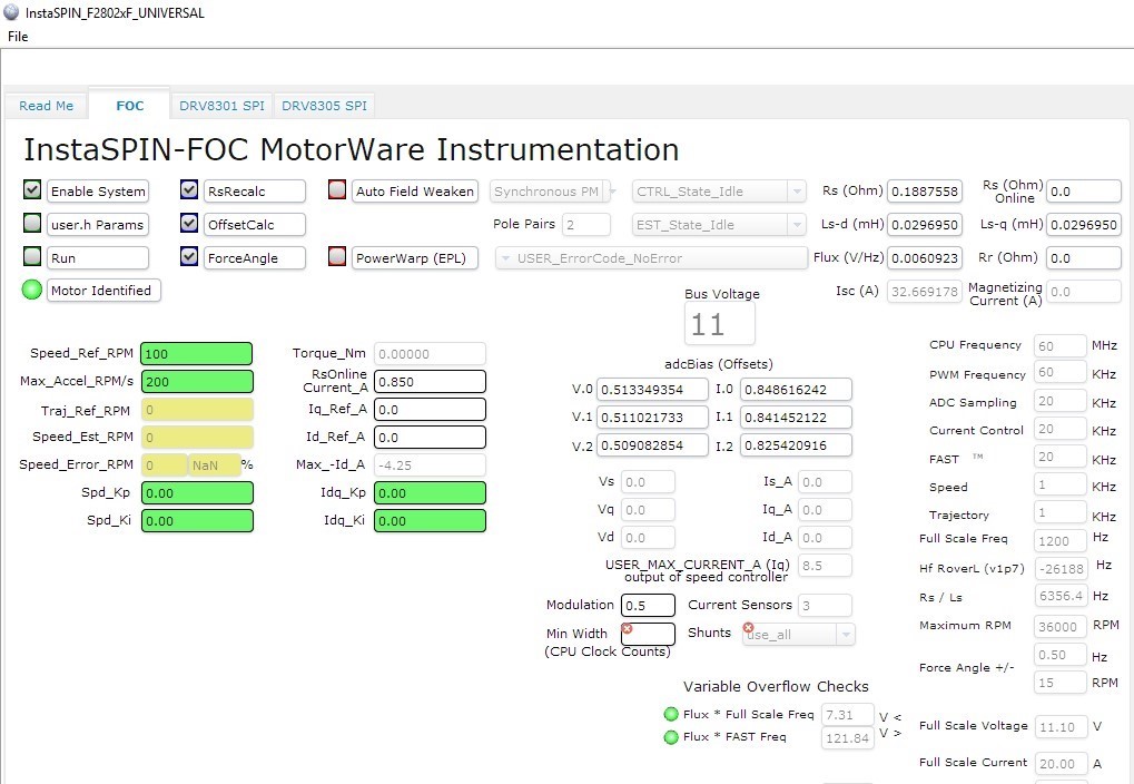

    Here are the most recent results from a Lab02c motor identification using the UNIVERSAL GUI:
    The Motor stopped in the Ramp Up state (0.12A, ~2000rpm) and continued spinning again in the Rated flux state (0.14A, ~3500rpm) continuing on to complete the rest of the identification sequence.
    I am currently reading through the Sanity Checks provided in the UNIVERSAL GUI QSG to make the necessary adjustments.

  • Hi Yanming,
    I have stepped through the “Motor ID Tips” tuning suggestions, and the only way for the motors to complete the identifications is from changing the RES_EST_CURRENT from 0.3A to 0.85A. I realised I had forgotten to change these when I changed MOTOR_MAX_CURRENT from 3A to 8.5A.
    Here are my new settings that allow for a full completion of the motor identification cycle.
    //! \brief CURRENTS AND VOLTAGES
    #define USER_IQ_FULL_SCALE_FREQ_Hz     (986) //calculated from variables spreadsheet
    #define USER_IQ_FULL_SCALE_VOLTAGE_V   (11.1)
    #define USER_PWM_FREQ_kHz             (60.0)
    #define USER_R_OVER_L_EST_FREQ_Hz       (300)
    //! \brief USER MOTOR & ID SETTINGS
    #define USER_MOTOR_TYPE                 MOTOR_Type_Pm
    #define USER_MOTOR_NUM_POLE_PAIRS       (1) //Motor only has 2 poles
    #define USER_MOTOR_Rr                   (NULL)
    #define USER_MOTOR_Rs                   (NULL)
    #define USER_MOTOR_Ls_d                (NULL)
    #define USER_MOTOR_Ls_q                 (NULL)
    #define USER_MOTOR_RATED_FLUX           (NULL)
    #define USER_MOTOR_MAGNETIZING_CURRENT (NULL)
    #define USER_MOTOR_RES_EST_CURRENT     (0.85) //Required for RampUp completion
    #define USER_MOTOR_IND_EST_CURRENT     (-0.85)//10% of Max Current
    #define USER_MOTOR_MAX_CURRENT         (8.5)
    #define USER_MOTOR_FLUX_EST_FREQ_Hz     (90)  //From variables spreadsheet
    The results were as follows:
    The short circuit current seems to be quite large at 86.5A; however, the RS & flux variable are quite similar to my previous tests.
    After I completed the Identification, I then transferred the parameters (including adc bias offsets) into User.h file and tried to run Lab05b; however, I could not enable the system to begin the lab.
    Do you know why I am unable to run this lab with my newly obtained parameters? Do you think it is related to the high Isc value?
    Kind Regards,
    Riley
  • Is there any Error report in the CCS project or GUI? Like gMotorVars.UserErrorCode. You might follow instaSPIN lab guide to debug the project with CCS, not using the GUI which is good for demo or control, not tuning the design.
    I can't fully understand what you mean "the short circuit current seems to be quite large at 86.5A" and "high Isc value". It seemd like the motor didn't start running, and didn't have any feedback speed. Did you enable force angle in your project, is there any load on the motor during the startup? Please refer to section 14 of instaSPIN User's Guide ( SPRUHJ1G) for startup setting.
    Could you please post some motor current waveforms to show the running state, especially the motor stopped by some faults.
