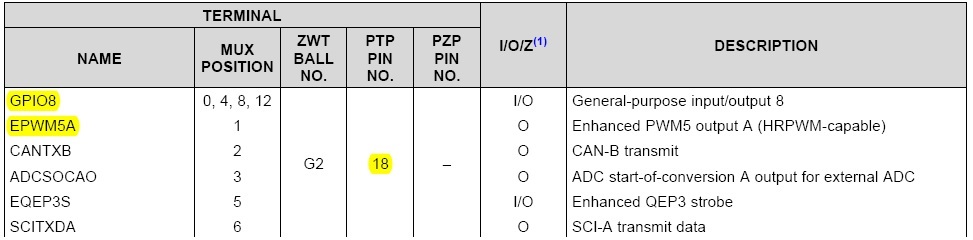

    My main doubt is about selection of external ADC SOC.
    Pls refer the following table.Actually,we need 24 ePWMs with 176 pin package for our application.
    So,there are some restrictions in using GPIO pin resources.
    Routing GPIO8 (which is originally assigned for PWM5A) to start of conversion pin of external ADC (MAX1312) will lead to running out of PWM channels.
    Pls refer the following figure for external ADC timing characteristics.
    Without violating the above timing parameters,
    Can i take any GPIO pin & simply route to start of conversion pin of external ADC (MAX1312)?
    or Can i use cross bar(X bar) structure as shown below to initiate external ADC SOC?
    In the following figure,what does ADCSOCEXT meant for?
    Pls solve my doubts regarding the above queries.

    Any GPIO should be fine for the various external ADC signals, but you can make life much easier on yourself if you select a contiguous and byte-aligned group of GPIO for D0 to D11.  e.g. GPIO32 - GPIO43.  This will ease packing/unpacking data to write to or read from the parallel interface.
    ADCEXTSOC is not what you want for interfacing to an external ADC; this is for an external trigger coming in to trigger the on-chip ADCs.
    ADCSOCAO or ADCSOCBO are the outputs you'd want.  These come from the PWMs to trigger an external ADC.  This output signal is pulse-stretched per the timings in figure 5-53 that you quoted above.
