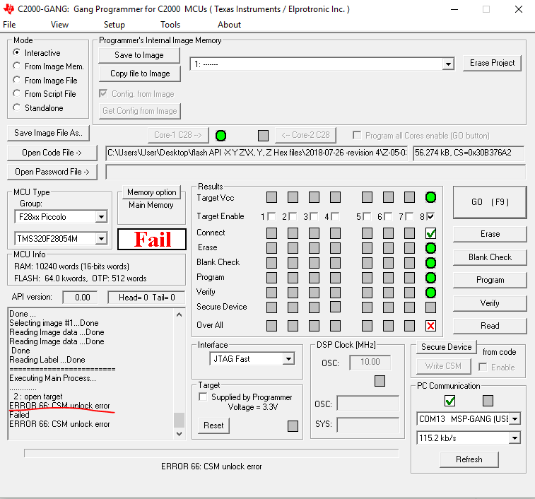

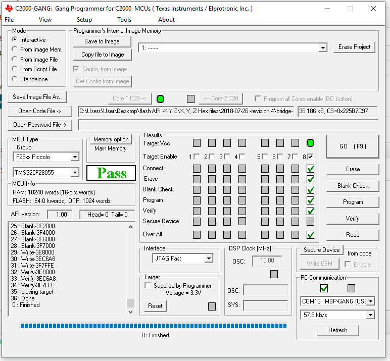

I am using C2000-GANG to program both TMS320F28055 and TMS320F28054M, TMS320F28055 has no problem to be programmed with C2000-GANG.
But TMS320F28054M kept giving me error 66: CSM unlock error.

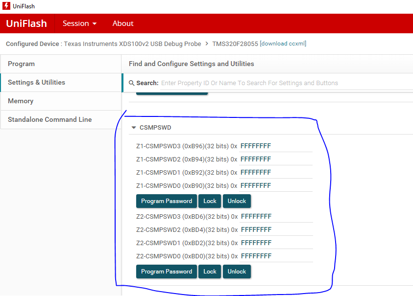

BTW, I went back to use UNIFLASH to program the TMS320F28054M with XDS100v2 USB debugger, no issue. same hex file.

1. I tried both programmed one and new chip(never programmed before), both stopped at ERROR 66: CSM unlocked error.
2. I can program TMS320F28055 multiple times without any issues using c2000 gang.
3. I also try to just Verify the programmed one (by UniFlash) using c2000 gang, and the same error shows up. ERROR 66
4. For UNIFLASH, I didn't change any settings, the default password for Z1 and Z2 are both 0XFFFFFFF.

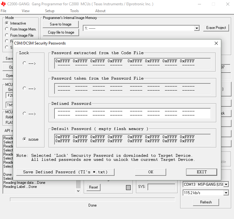

5. For C2000 GANG, I tried all the Security Password setting, none of them works.

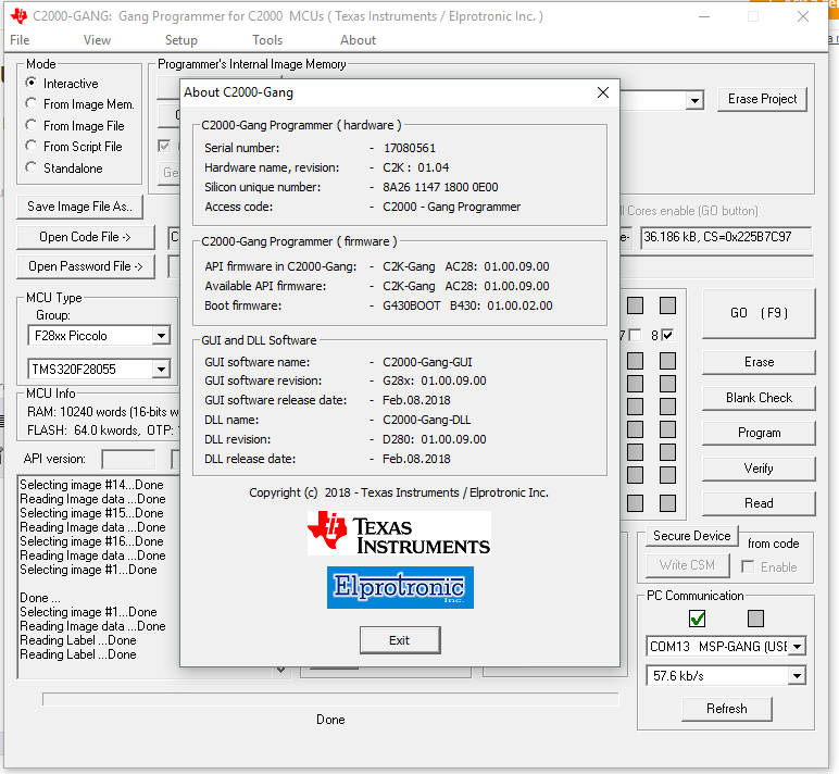

We are trying to reproduce the problem. BTW - What software version are you using?
