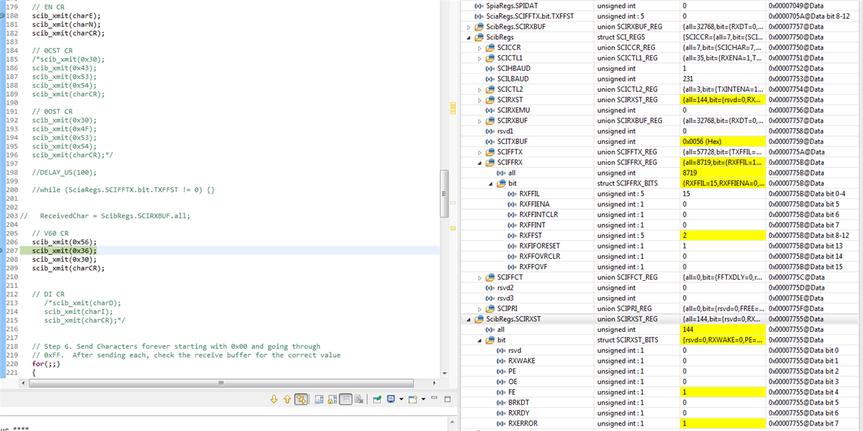

  • Hi Sal,
    Thank you for considering my problem.
    The motor is expecting this format :
    - 8 bits length,
    - no parity,
    - 1 stop bit.
    The baud rate is 9600.
    So I've set the SCI_b like this :
    SPICCR = 0x07 (8 bits length, no parity, 1 stop bit, no loopback, idle line mode protocol as the protocol used is RS232).
    SCIHBAUD = 0x01;
    SCILBAUD = 0x07; (BRR = 487 => with LSPCLK = 37.5 MHz the SCI baud is 9600).
    Using the debug mode (step by step) I see that the Frame Error occurs when i send the first char of V60 command. Also I see that the FIFO receive register has 2 words at the exact same moment FE is set.
    The motor came with a demo card and a software. I can reproduce the exact same commands and see the terminal transmitted and received messages. With the motor's software the commands are correctly executed by the motor.
    I've updated my commands in order to be exactly in the same conditions as the software's ones :

  • I am not sure what the issue is here right now.
    Can you try disconnecting the motor and enabling loopback? Just to make sure the SCI is configured properly and working?
    The next thing to do would be to hook up an oscilloscope or communication analyzer to see what is being sent and received on the SCI communication lines.
    sal

  • Hi Sal,
    I think that we did a huge mistake... Can you confirm us that the SCI uses the bit levels 0V (state 0) and +Vcc (or +Vdd ?) (state 1) ? Because that's what we see on the oscilloscope... SCI uses TTL or CMOS logic ?
    In this case I think we can't communicate with our motor which is using the RS232 logic :
    - state 0 : +3V to +15V
    - state 1 : -3V to -15V
    The solution would be to use a MAX 232 hardware interface in order to convert the logic levels ?
    Many thanks,
    Yes, state 0 is 0V and state 1 is 3.3V.
    sal
