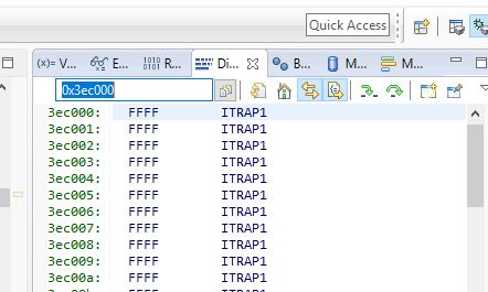

  • Here's the disassembly:
    So it's clear that there is something wrong with the code that it is executing.

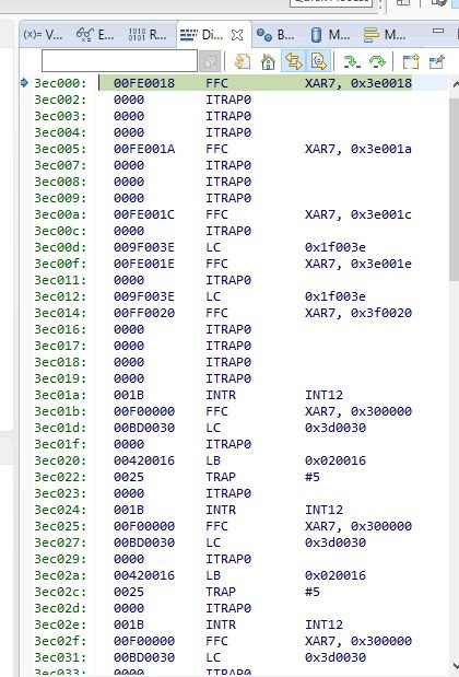

    I went back and looked at the hex file that I was copying, and interesting when I compare the code in the FLASHC location from the workspace_v7 (which has the image loaded directly through a JTAG), I see the values in the disassembly as follows:
    So, it appears, the code didn't get copied correctly. The Flash_Program() takes in a Uint16*. The output of the hex file is a 8-bit characters. Can I get the hex to output a 16-bit word? Clearly, me mashing the two 8-bit words together was done incorrectly.

    Doing this runs immediately into an ILLEGAL_ISR
    I'm getting frustrated. Either I'm doing something so basically wrong, or I'm missing a step that I have not read about. PLEASE HELP!
  • Parag,
    Value programmed in address 0x3EC000 = 0xFFFE is not a valid opcode. When executing 0xFFFE CPU realizes that it isn't a valid opcode and jump to ILLEGAL_ISR().
    I don't know how you have configured your application code. Assuming you tested your application code to be working when you programmed using CCS plugin. I would assume that you have got your jump address wrong. When you want to jump to your newly programmed code you need to jump to address of the 1st opcode you need to run. What is the BEGIN address of the hex code you are programming using Flash API? What does .cmd file say?
    Manoj
  • Manoj, you are correct. In my attempts to debug, I did change the asm call to 0x3eC000 and forgot to change it back to what BEGIN was using. THE CODE IS WORKING NOW AS EXPECTED!
