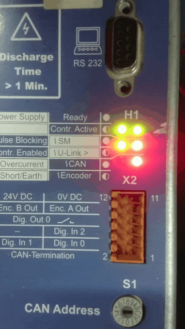

  • Hello Mr. Hareesh J. I want to describe in detail my equipment. This is a frequency converter for the DC motor from the machine for textile production TRUTZSCHLER. The inverter has various errors, and when checking it, I did not find out the problem except the processor and so I wanted to replace the processor and explain the cause of the failure. Yesterday I created a .out file from your linker and everything went well. After programming, I compared the memo from 0x0000 to 0x8000 and everything was the same. But after restarting in memory 0x0000 to 0x8000 everything changes and is set as if by default.

    I want to note that when choosing On-Chip Flash Programmer CCS gives an error
    There are 3 switches on the board and all positions are OFF. If you switch to the ON position and connect and select the On-Chip Flash Programmer then there is no error. I screwed these switches to datashit
    S97.1- boot_EN_XF//
    OFF=Flash Execute
    On=Boot ROM
    S97.3-Vccp
    OFF=0V
    ON=5V
    S97.2-MP/MC
    OFF=On-Chip Flash Memory (Sectored) - if MP/MC = 0
    ON=External Program Memory - if MP/MC = 1
    But if everything is correctly programmed then it is possible and without switching the switches to the ON position, select On-Chip Flash Programmer and without warning you can enter the programming window
    After unsuccessful attempts to program, I took EEPROM and FLASH MEMORY and reprogrammed it with my programmer, as I wrote after reprogramming and restarting the processor everything from 0x0000 to 0x8000 was set to other values but after I connected with CCS3.3 and chose the RUN mode in and everything became like in my firmware and the miracle worked. I wanted to find out the reason and tried to reprogram EEPROM and FLASH MEMORY on another device but it got out.
    If you remove the FLASH MEMORY and connect to the CCS then all addresses except SARAM 0x8000 to 0x8800 only FFFF
    e2e.ti.com/.../fault.rar
    Information LEDs for faulty programming
    e2e.ti.com/.../OK-WORK.rar
    Information LEDs with good programming
    I will continue to try, if there are any ideas, please let me know
  • I tried again to start my board and when the power was turned on, the LEDs did not turn on and I connected with the help of CCS and clicked on the Reset CPU and after Run Free. And everything starts and works. After restarting, everything was normal. What could be the problem?

  • Yes comparison of the same and checksum too. Problem was in a bad contact processor. Thank you for high help Mr. Hareesh J
