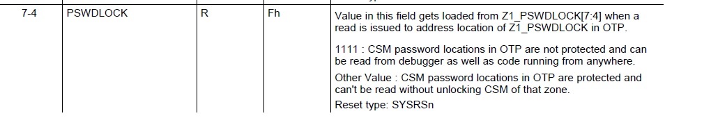

I am trying to activate the password lock on 280049 to solve a question of my customer.
He wrote 0xFFFFFFEF  in Z1OTP_PSWDLOCK, which, according to the post, will not activate the password lock.
The reason he did so is that it is said in the TRM, the Z1_OTPSECLOCK register password field actually gets loaded from Z1OTP_PSWDLOCK[7:4].
My question is, if PASWDLOCK value is Z1OTP_PSWDLOCK[3:0], how can Z1_OTPSECLOCK register password field reflect the state of password lock? Is it a mistake?
If my customer has already written 0xFFFFFFEF  in Z1OTP_PSWDLOCK, can he activate the password lock on the same socket?
Besides, I did  tried to write 0xFB7FFFEF in Z1OTP_PSWDLOCK(just a random number), my 280049 password lock worked. How could this happen?

  • To make it clear, my customer is using 28337D.
    There are two main points I want to make sure.
    1. Which bits I need to modify in Z1OTP_PSWDLOCK, to enable the password lock(Very Important)? Only Z1OTP_PSWDLOCK[0:3] will work?
    2. In the TRM, it is mentioned Z1_OTPSECLOCK register password field actually gets loaded from Z1OTP_PSWDLOCK[7:4](pls look at the picture I posted). If I need to modify Z1OTP_PSWDLOCK[0:3], while the Z1_OTPSECLOCK loads Z1OTP_PSWDLOCK[7:4], what is the point?
    3. My customer wrote 0XFFFFFFEE, the whole zone became visible. How could this happen?
    Yes, you need to modify Z1OTP_PSWDLOCK[0:3] to enable password lock feature.
    Sorry, that need to be corrected. It should say "Z1OTP_PSWDLOCK[3:0]" instead.
    We'll correct it in next release. Thank you for your valuable feedback.
