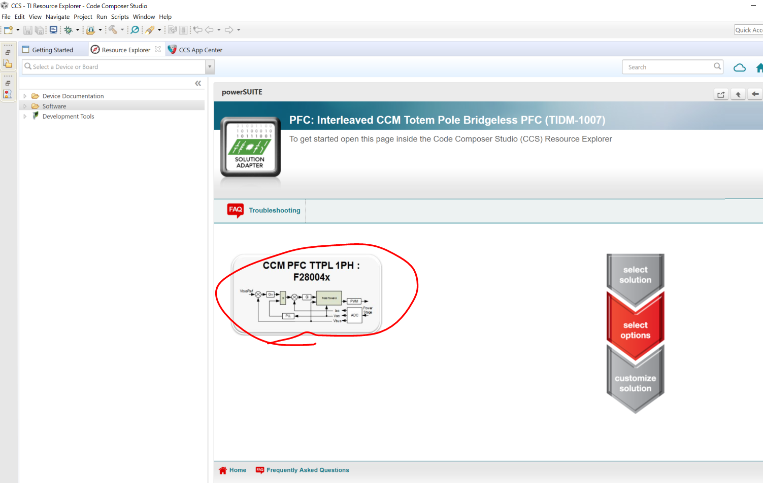

hi, All.
when i tried to click to be next as below, i couldnt do it with some reason.
How do I do troubleshooting ?

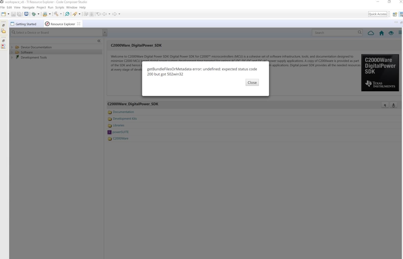

    there is also error comes up as below.
    how do i fix it?

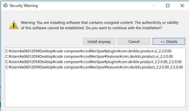

  • From the error message, it looks like there is a path mismatch. It seems to have inserted some different symbols, yen sign (¥), in the place of the forward slash, (/). Please check to see that the install path uses (/) to separate the folders.
    In the meantime, try to see if you can go to the Resource Explorer in CCS and install the powerSUITE tool. At the home page, scroll and down and look for the powerSUITE symbol and install the latest version. Follow the steps to install the tool.

    it came the error message up here.
    what should we do?
    speaking the "directly address" such as ¥ i, ¥ is normal in japan as my thought.
    even i tried to change "/" from "¥" , the "/" would be "¥" automatically and i couldn't set whole address what error message showed.
    what i can set is the just the place where I want to install but not the address what error message showed.

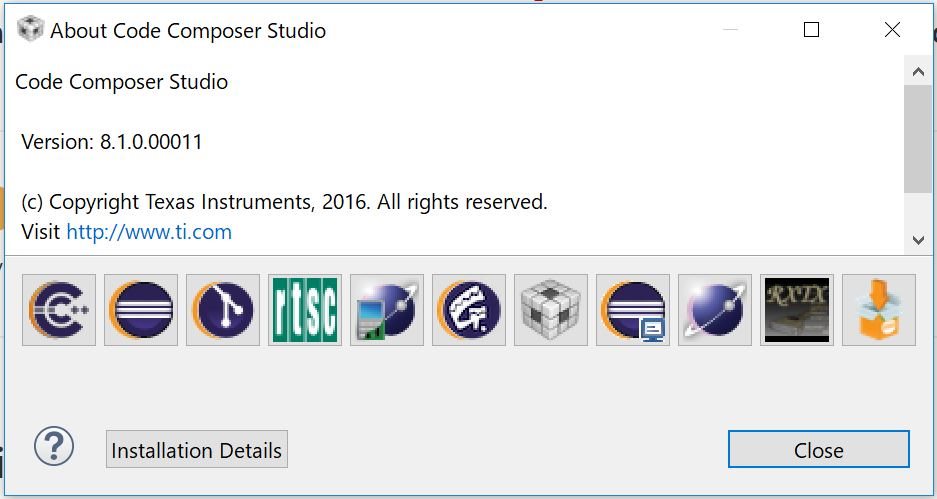

    1) Which version of CCS are you using?
    2) Did you try downloading and installing the latest version of C2000Ware_DigitalPower_SDK by clicking the icon shown below? Is that when you see an error and what is the error?
  • the CCS i've used is the following.
    you're right.
    when i faced the error, I was about to try to click there to download on CCS.

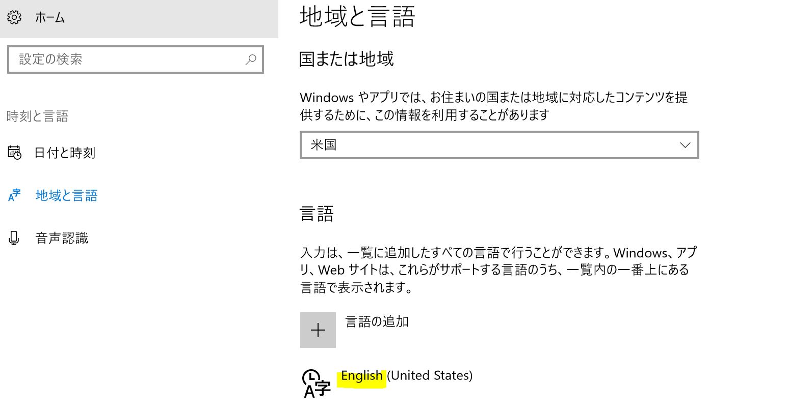

  • i changed the language English in laptop as below.
    it was same result as i asked first. so still problem there as i couldn't use CCM PFC TTPL 1PH
