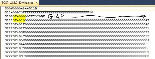

    I talked to the contact (name K. W.) on embedded side to understand what's going on there and I think that the infrastructure there is different with infrastructure in our group and the CAN packet definition and CAN stack are quite different.  Anyway, I found was that the Motorolla Srec format was the way to go to translate from .out to .srec using hex2000.exe from TI.  The embedded group take the .srec and their surface tool platform (*scope*) handles it directly from there.  Other method of generating .bin from CCS produced the other format that seems to work with TI CKFA binary which is not what we wanted for custom boot loader.
    The next step I used TI utility FileIOShell.exe  which supposes to translate from .srec to binary and did not work correctly.  The reason is that the .srec has gap (see attachment) and other RAM addresses that the FileIOShell.exe did not take care of .  The generated bin file crashed after loading.
    I looked up the srec format and wrote my own parser to auto fill the "word" addressable "gap" from srec line by line and eliminate any RAM address references.  The generated bin file worked fine.  I have the standalone srec to bin that works with generic .srec input, .bin output, application starting address and its sector size.
    I can share this parser as a reference to anyone who struggles to generate the correct bin file like i did.  The snap shot showed the post-process steps i used in CCS to call the hex2000.exe to generate .srec and our custom srec2bin.exe to generate final bin.
