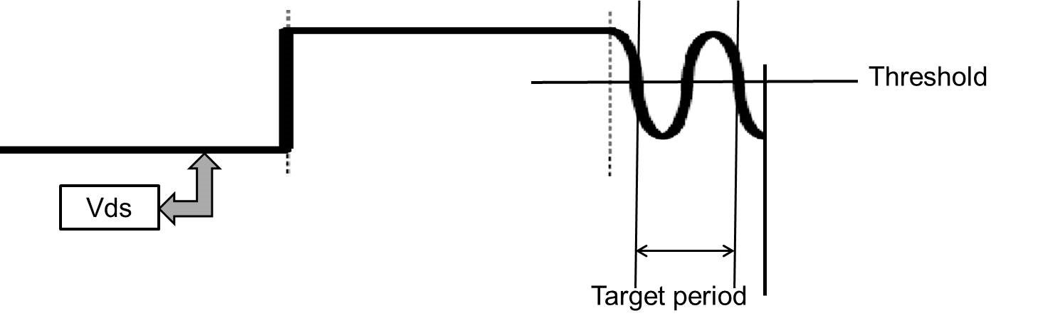

B. EPWMBLANK
I plan on using CMPB for MAX DUTY control, and want to reset the ramp generator at that time. So I will need to using the EPWM1BLANK instead. I was able to get it to work using the code below.
    EPwm1Regs.DCFCTL.bit.PULSESEL = 1;          // TBCTR = 0
    EPwm1Regs.DCFOFFSET = 709;                  // Offset of 709 and Window of 1 seems to work for some reason
    EPwm1Regs.DCFWINDOW = 1;
    EPwm1Regs.DCFCTL.bit.BLANKE = 1;            // Enable the blanking window
However the DCFOFFSET + DCFWINDOW values were not what I expected. The TBPRD is 714, and only with DCFOFFSET + DCFWINDOW = 710 will this work. Otherwise the timing is off and the result looks the same as the waveform above. Do you have any insight why 710 out of a TBPRD of 714 is required? I had to trial-and-error-hand-tune this to get it to work. The only thing I can think of is some unspecified delay between the CMPSS output and the AQ deciding to take action on the PWM.

    Regarding the DCFOFFSET + DCFWINDOW, Figure 18-55. Blanking Window Timing Diagram - shows the configuration needed.
    I do not think I understand your concern/observation regarding this.
    Here is what you might be missing in your configuration -
    Try to set Pwm1Regs.AQTSRCSEL.bit.T1SEL this to DCEVTFILT - instead of raw DCEVTx.
    Now with the blanking enabled - at the end of blanking window, there should be an event on DCEVTFILT, and that in turn would turn off the PWM.
    If you use the raw DCxEVT in this case there is no edge on the DCxEVT and hence it would not trigger the T1 event inside the action qualifier.

    "Try to set Pwm1Regs.AQTSRCSEL.bit.T1SEL this to DCEVTFILT - instead of raw DCEVTx... Figure 18-55. Blanking Window Timing Diagram - shows the configuration needed."
    DCEVTFILT will only ignore event occurrences during the window, not clear them. Section 18.3.9.4.2 says "During the blanking window, all events are ignored. Before and after the blanking window ends, events can generate soc, sync, interrupt, and force signals as before."
    I tested it out just to make sure, and I confirmed that it does exactly as expected - the DCEVTx is constantly asserted and the PWM never resets (see the beginning of the original post).
    I think this simply reaffirms that I need to use the blanking feature of the CMPSS, to de-assert the CMPSS output and allow another DCEVTx rising edge to occur for the AQ to take action.

  • Thanks, can I get a high level sneak peak? :)
    Without needing to explain registers and bit settings, just conceptually how can it actually identify the valley point? My previous post assumed the designer had to have knowledge of the valley point timings ahead of time and program in those delays (whether static, look up table, or dynamic calculations).
    If I can just get the general idea of how the CMPSS and Valley Switching functions work together, I think I could put the pieces together from there. This is actually something that could be immediately useful for something I am working on.
    Thanks!
  • I'll tag the Valley Switching designer to respond with details.
  • Hi SRW,
    The figure above just shows a big picture on how to detect the valley point. The threshold can be set through a CMPSS module and the target period can be captured once the designed # of edge is detected. Then a 1/4 of period delay following the final edge in this situation is added to find the valley point. Like you mentioned, the dynamic calculation is implemented to achieve best performance. Hope this helps.
    Chen
  • Great, thank you Chen. Makes sense now with that Figure.
    Thank you both for the help.
