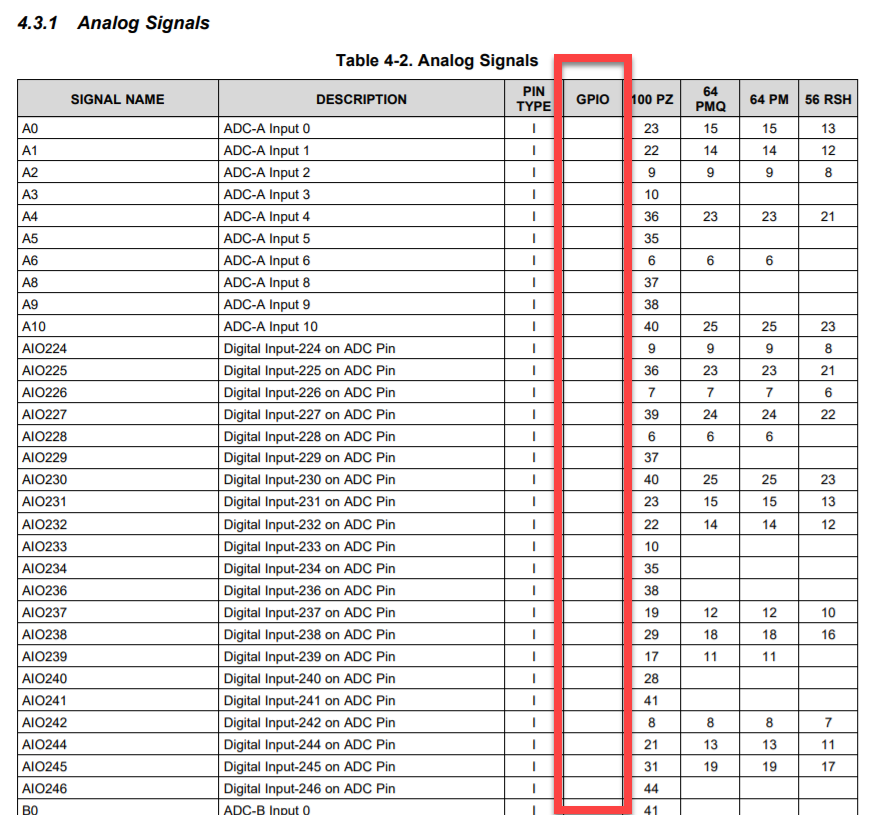

    The answer is NO. You can't connect any analog IO pin to x-bar and as you can see in the image below, GPIO pins only can be connected to input x-bar

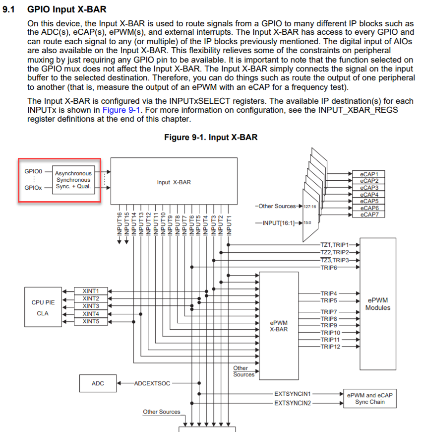

    I have captured a screenshot for you to show that the INPUTXBAR Pins are exactly GPIO pins.
    Final conclusion(from section 9.1):
    the Input X-BAR is used to route signals from a GPIO to many different IP blocks such as the ADC(s), eCAP(s), ePWM(s), and external interrupts. The Input X-BAR has access to every GPIO and can route each signal to any (or multiple) of the IP blocks previously mentioned. The digital input of AIOs are also available on the Input X-BAR.

    I want to say that you are right and expect TI engineers to confirm this issue. Here we have two statements in TMS320F28004x Piccolo™ Microcontrollers
    Technical Reference Manual, SPRUI33A:
    1-The Input X-BAR is used to route signals from a GPIO to many different IP blocks such as the ADCs, eCAPs, ePWMs, and external interrupts ......
    So it doesn't say some of GPIOs so that we can understand that Input X-BAR has access to every GPIO.
    2-On the other hand, it is stated that "The digital input of AIOs are also available on the Input X-BAR."
    If we compare these two statements with the table below, I think we can find a contradiction between them, because none of the digital input of AIOs is assigned to any of GPIOs, so that we can conclude that "The digital input of AIOs are also available on the Input X-BAR"  is not correct because these SIGNALs don't come from GPIOs and this is the logical reason that we can't find digital input of AIO pin numbers under the menu of INPUTXBAR in TI PinMux.
    As I found out, the PinMux is OK, but Technical Reference Manual needs to be changed and the statement "The digital input of AIOs are also available on the Input X-BAR" should be removed in the next TRM release.
    I'll be happy if someone from TI documentation team sees this post and confirms or refutes my suspicion.
    Thank you DTruex for putting this issue in front of my eyes.
    Hossein
  • From my origional post:
    "The technical ref manual (SPRUI33A–November 2015–Revised December 2017) section 8.1 says:
    The analog signals on this device are multiplexed with digital inputs. These analog IO (AIO) pins do not
    have digital output capability. They are assigned to a single port:
    • Port H consists of GPIO224-GPIO247"
    I agree with you that if this statement is factual it should be reflected in table 4-2 however I did not interpret their omission from table 4-2 to imply they are not mapped to GPIO since section 8.1 explicitly says that they are.  Taken with the statement in 9.1 that says "the input x bar has access to every GPIO" it seems unambiguous that AIO digital inputs are available at the input x bar.
