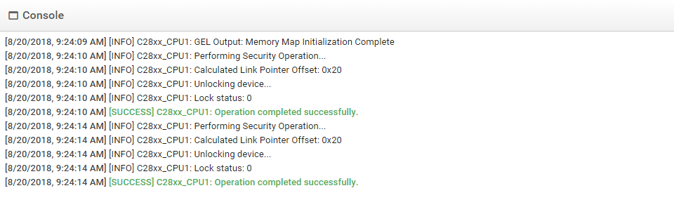

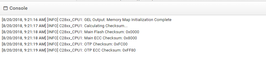

My customer built 10 pcs control boards using F28075. And during their debugging, they found half of them cannot be programmed, on which F28075 are brand new samples. I am testing those failure samples and you can refer to the results as follows. And CCSv7.2 and XDS110 were used.
1. Test connection passed, and the result is " The JTAG DR Integrity scan-test has succeeded.";
2. RAM version project can be downloaded and debugged;

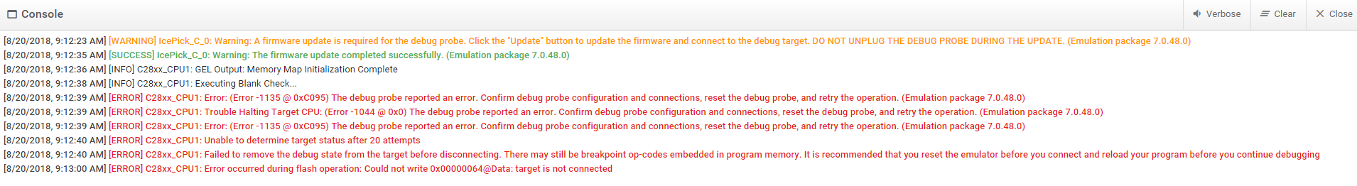

3. Flash version project(we use flash_programming) cannot be programmed successfully. And CCS process bar was stuck as the following stage.
After that, the load failed message was appeared.
 The information in console windows was as follows.
C28xx_CPU1: GEL Output:
Memory Map Initialization Complete
C28xx_CPU1: Error: (Error -1135 @ 0xC0CC) The debug probe reported an error. Confirm debug probe configuration and connections, reset the debug probe, and retry the operation. (Emulation package 6.0.628.3)
C28xx_CPU1: Trouble Halting Target CPU: (Error -1044 @ 0x0) The debug probe reported an error. Confirm debug probe configuration and connections, reset the debug probe, and retry the operation. (Emulation package 6.0.628.3)
C28xx_CPU1: Unable to determine target status after 20 attempts
C28xx_CPU1: Failed to remove the debug state from the target before disconnecting. There may still be breakpoint op-codes embedded in program memory. It is recommended that you reset the emulator before you connect and reload your program before you continue debugging
C28xx_CPU1: Error occurred during flash operation: Could not write 0x00000064@Data: target is not connected
C28xx_CPU1: Error occurred during flash operation: Could not read 0x00130@Program: target is not connected
C28xx_CPU1: Error writing the PLL values. (Flash algorithm returned error code). Operation cancelled.
C28xx_CPU1: File Loader: Memory write failed: Unknown error
C28xx_CPU1: GEL: File: C:\TI\controlSUITE\device_support\F2807x\v210\F2807x_examples_Cpu1\flash_programming\cpu01\ccs\CPU1_FLASH\flash_programming_cpu01.out: Load failed.
