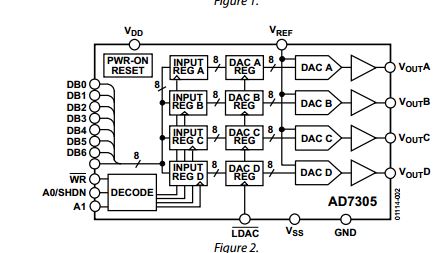

dear team,
i am doing my paper on induction motor control on TMDSHVMTRPFCKIT with tms320f28035 control card, but due to limited GPIO pins on this kit; connected to other external circuit in the main board of the kit.i used to load 8bit data GPIO 16,17,18,19,22,24,25,26 pins. also GPIO 06 TO /LDAC of AD7305; GPIO 32,33,39 connected to A0,A1,/WR OF AD7305. these GPIO PINS are not connected external circuit(i.e free).i want to load the result for my case torque, speed and flux from my algorithm, to display and plot at DAC output(AD7305 device). but i get code error. all the information related to this question attached below
update_AD7305();
// To display the system values at DAC output pins
AD7305_CH_A= (PI_out*25);
AD7305_CH_B= (torque*25);
// Plot the circular trajectory of Actual stator flux
AD7305_CH_C= ((d_flux*255)+255)/2;
AD7305_CH_D= ((q_flux*255)+255)/2;

  • 1. Please add #include "PeripheralHeaderIncludes.h" in this file you added, and set right #include search path in your project.
    2. Please refer to the GPIO definition in "DSP2803x_Gpio.h" , there is no "GPIO06", it's "GPIO6".

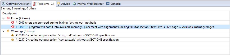

  • thanks a lot. i can fix it based on your comment. but i got another error. how can i fix it.
    "../sources/28035_RAM_lnk.cmd", line 85: error #10263: BEGIN memory range has
    already been specified
    "../sources/28035_RAM_lnk.cmd", line 85: error #10264: BEGIN memory range
    overlaps existing memory range BEGIN
    >> Compilation failure

    warning #10247-D: creating output section "csm_rsvd" without a SECTIONS specification
    warning #10247-D: creating output section "csmpasswds" without a SECTIONS specification
    "../28035_RAM_lnk.cmd", line 112: error #10099-D: program will not fit into available memory. placement with alignment/blocking fails for section ".text" size 0x1295 page 0. Available memory ranges:
    RAML0L1 size: 0xc00 unused: 0xc00 max hole: 0xc00
    error #10010: errors encountered during linking; "dtcimc.out" not built
    gmake: *** [dtcimc.out] Error 1
    gmake: Target `all' not remade because of errors.
    **** Build Finished ****

  • thanks a lot for helping,suggestion and comments, know i got this type of error
  • Sorry, it seems like the cmd file is not correct, can't find some sections or the definition of a section is not correct. I can't tell you how to solve this question since there is not enough information you posted. Please post whole cmd file or project. As talked above, you might have a look at the training material to know how to design the cmd file.
  • this is the error, and i attached the whole code below. the code is written on ccsv6.dtcimc.rar
  • It seems like the length of ".text" is not enough and you didn't define correct sections, you might have a look at below threads to understand the .cmd file to re-design it, and you'd better design yourself .cmd file based on a correct example .cmd file.

  • Hello Yanming Luo,
    thank you your continuously replaying my questions.  i build my code it shows no error, when i used the file name F28035_RAM_HVACI_Sensored.CMD attached below. but i have the a question in this cmd file.
