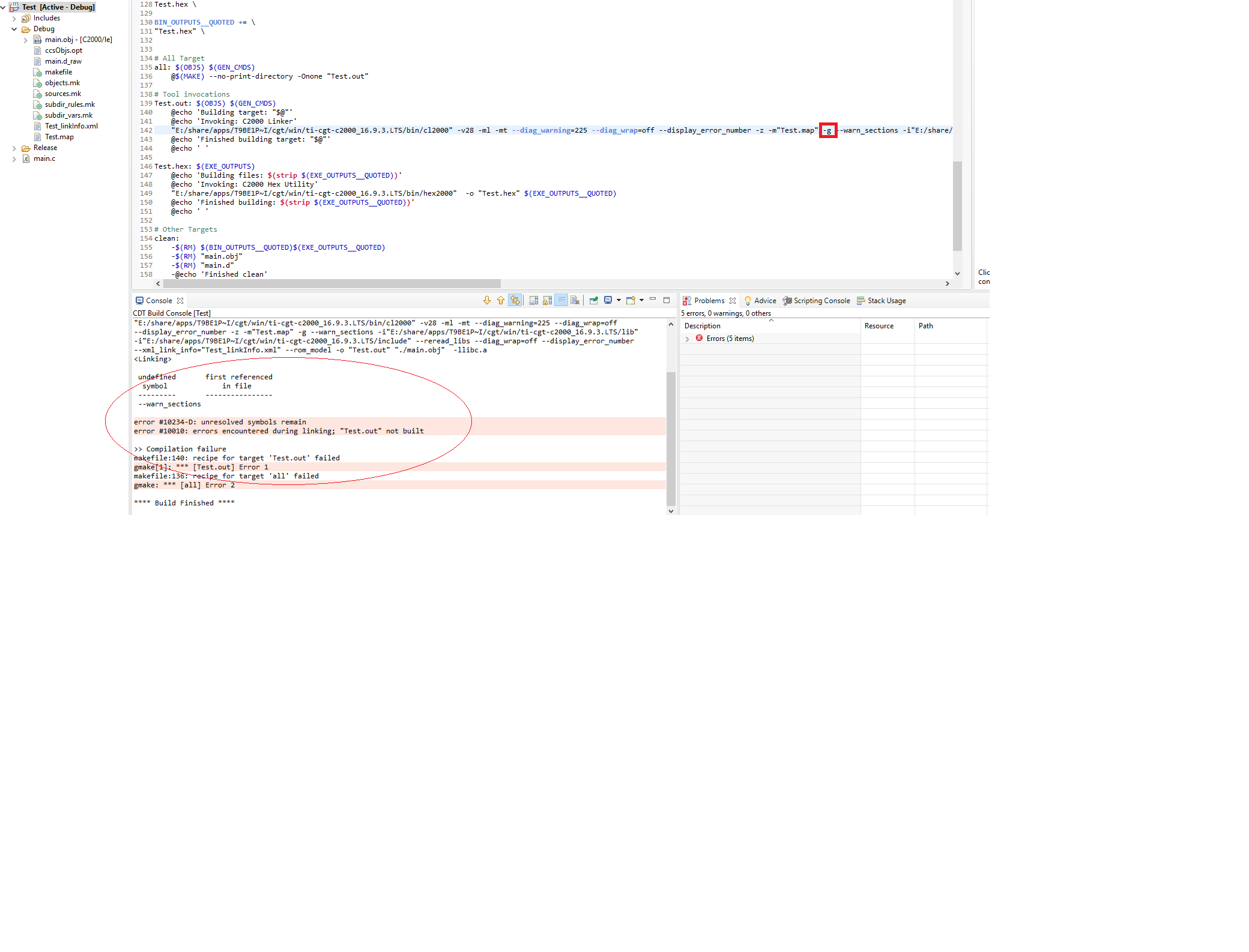

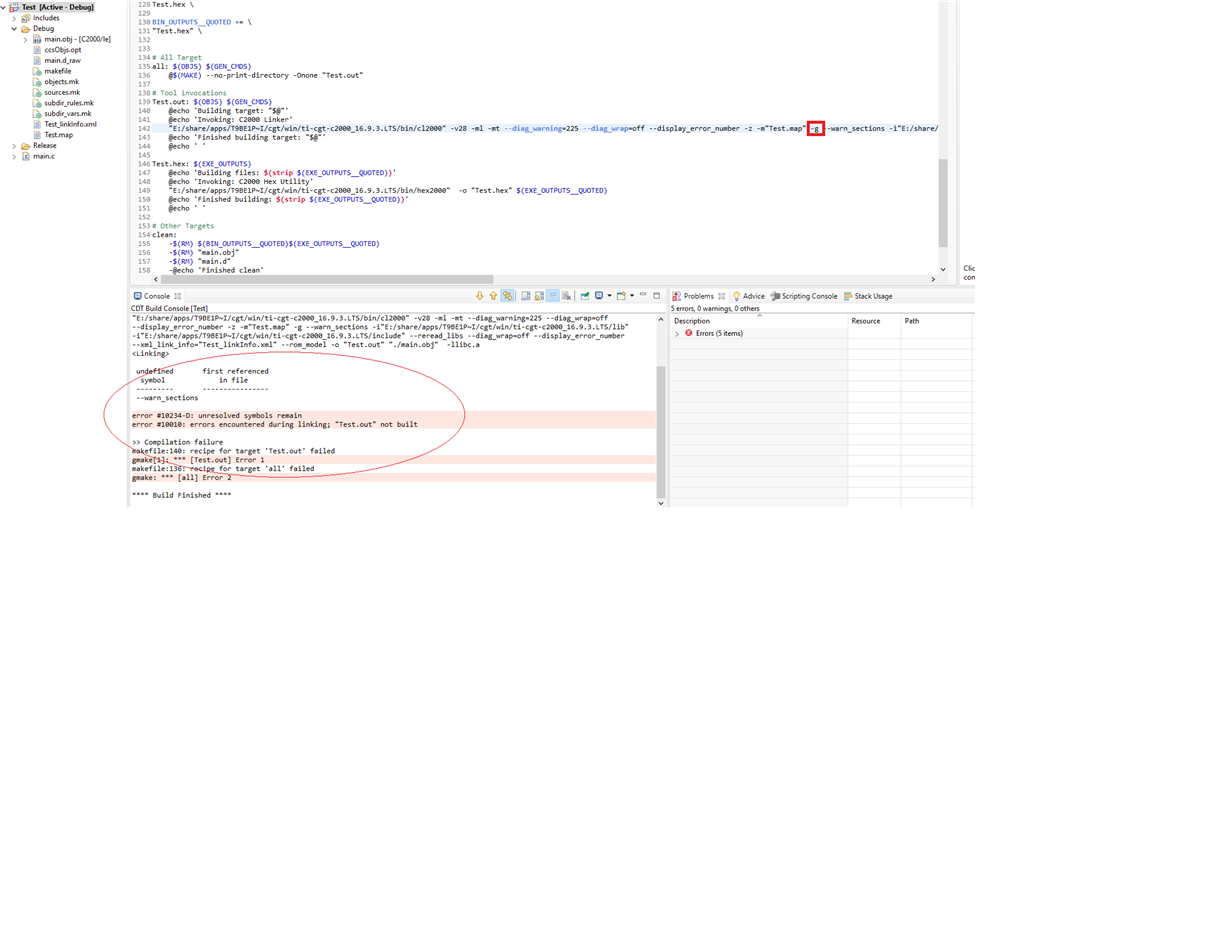

If I try to change the order of the -g flag as shown below (defined after the map file flag and before warn_section flag)
-v28 -ml -mt --diag_warning=225 --diag_wrap=off --display_error_number -z -m"Test.map" -g --warn_sections -i"E:/share/apps/T9BE1P~I/cgt/win/ti-cgt-c2000_16.9.3.LTS/lib" -i"E:/share/apps/T9BE1P~I/cgt/win/ti-cgt-c2000_16.9.3.LTS/include" --reread_libs --diag_wrap=off --display_error_number --xml_link_info="Test_linkInfo.xml" --rom_model
the linking fails with error that it does not recognize the next flag --warn_sections.
Is the flag -g order is fixed that it has to be used before certain flags? Is the order mandatory for any other flags used for linker?

  • Aditya,
    Notice the -z option in the command line.  Everything to the left of the -z is a compiler option, and NOT a linker option.  The linker options are to the right of the -z.
    In your first case with the -g at the beginning of the command line, it tells the compiler to include symbolic debug information in the .out file.  See the C28x Compiler User's Guide, SPRU514p. Table 2-4, p.20.
