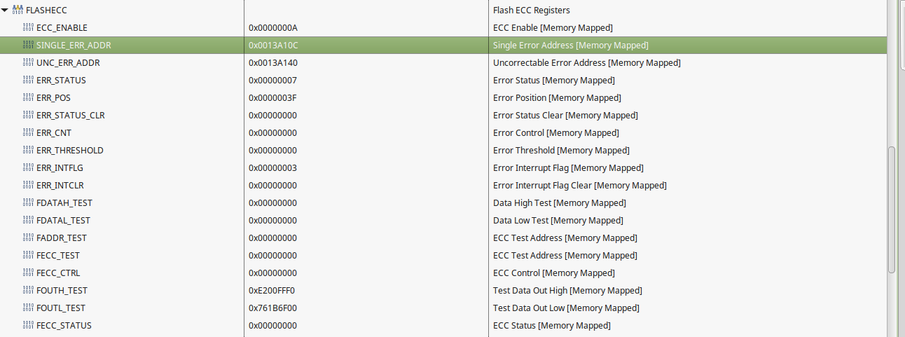

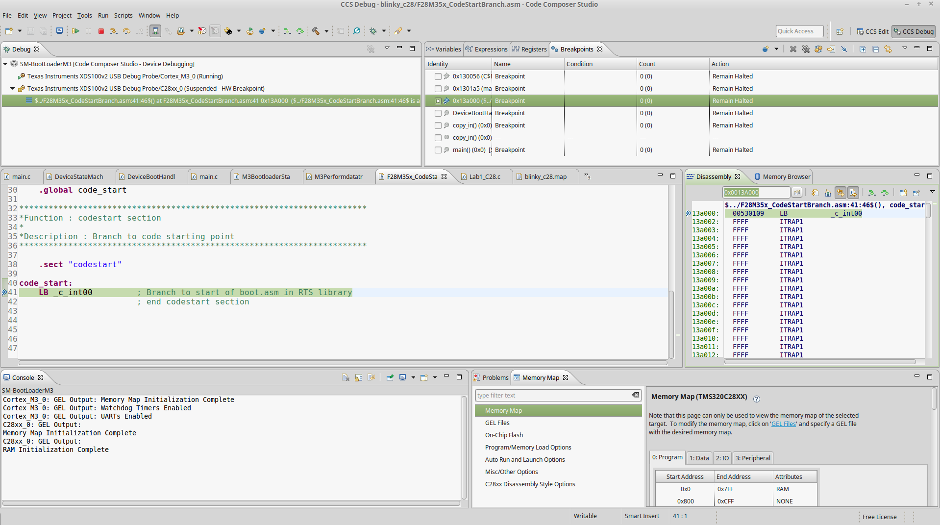

A Summary of my current problem:
Now once i program the c28 blinky through my c28 bootloader and jump to the blinky "codestart" section(0x13A000) which is the start of _c_int00, i hit the breakpoint at 0x13A000 and step in to the _c_init00 function. A few steps further the program gets stuck in a forever loop and does not reach _copy_in (got the flow as per blinky .map file).
In my previous post there was a complete reset after the jump but now i could atleast see that the reset is no more happening. Could i be missing sharing some resources between c28 bootloader and c28 blinky ? Or should i be aware of some initializations steps in my M3 Bootloader application which should transfer some resources to c28 blinky ? As of now i am sharing the GPIO resources for LED3 on concerto control card is this not sufficient enough ?
Some screen shots for References:
During the debugging session it halts in boot28.inc which i believe is part of TI library and can not be viewed. So how else could i trouble shoot this situation ?
  • Hello
    You should be able to find boot28 within the CCS installation and the compiler you are using.
    Ex: ~\ccsv8\tools\compiler\ti-cgt-c2000_18.1.3.LTS\lib\src
    Best regards
    Chris
  • Hi Christopher,
    Thanks for sharing this, it helped to troubleshoot by stepping through actual source code.

    1. I flashed my M3 Bootloader and C28 Bootloader and programmed C28 Blinky through the C28 Bootloader expecting something to happen. Now i see a different behavior compared to what i explain in my first post. Here when i get in to first instruction under START: routine inside boot28.inc  and step into i end up in a invalid address jump to address 0x13f11c. Below are some screenshots explaining this behavior.
      Here the XAR contains address value 0x13a2d0 and the value at this location is 0xffff as shown below
      Now the execution is stuck inside ESTOP0 as seen below
    2. Now the second part of troubleshooting i did, i flashed c28 blinky through JTAG and made changes on my c28 bootloader code to directly jump to 0x13BFF0 address and from here on i performed the same step in to as i did above. Now when i reached inside START: with same value of XAR, i expected a same behavior as above, but to my surprise the code actually executed fine and blinks the LED.
    Hope i am providing enough info for you guys to understand whats going on. Can you guys give me some hints on what could i check further

    Firstly the ILLEGAL_ISR which gets called from boot28.inc resides in the C28 Bootloader application. Is this fine ?
    The below screenshot shows the highlighted assembly sequence when executed ends up in ILLEGAL_ISR or ITRAP.
    Now when i step in to i actually end up in ILLEGAL_ISR routine which is residing in C28 Bootloader flash boundary. As seen in the below screen shot i have added some assembly line inside the ISR to extract the PC value where the ITRAP was generated. To my surprise the ACC gets updated with value 200 which could be seen in the screen shot as well. Does this mean i ended up here from location 0x200 ? Because the PC value at the above highlighted instruction was 0x0013A133. So this is totally confusing me now.
    Finally i wanted to show my stack values as well. Which brings up another question can C28 Bootloader and C28 Blinky have there stack start at RAMM0 in the linker script ? If not how could i plan my stack for two different applications ?

    2. You're getting an iTrap, which is when the CPU executes an invalid instruction. PREAD won't cause this. Do you have flash ECC enabled? When you get the itrap, can you check the register window for FLASHECC and see if you're getting any errors?

    I disable flash ECC before performing any program operation and at the very end i enable it again like below.
    FlashEccRegs.ECC_ENABLE.bit.ENABLE = 0x0;
    // Enable ECC
    FlashEccRegs.ECC_ENABLE.bit.ENABLE = 0xA;
    Below are the screenshots for FLASHECC registers.
    screenshot of FLASHCTRL

  • Preetham,
    I and Chris discussed on this last week and wanted to know if you noticed any ECC errors.
    From the register screenshots that you posted, I see that there are ECC errors (single and uncorrectable). And the error addresses that I see are actually near the address where you said you have PREAD.
    What Flash programming mode are you using? Fapi_AutoEccGeneration or Fapi_DataAndEcc?
    If Fapi_DataAndEcc, are you calculating the ECC using Fapi_calculateECC()?
    Once you program data in to Flash, make sure you verify it with ECC enabled. That tells whether you programmed ECC correctly or not.
