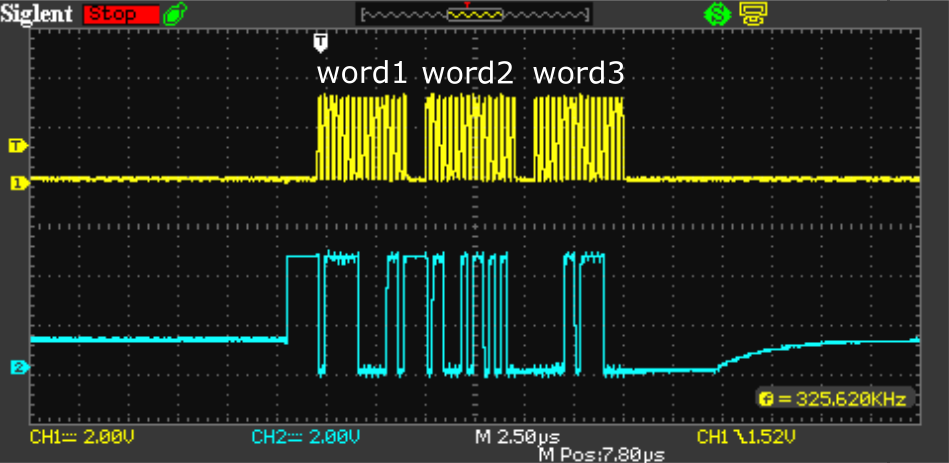

Hi, I am using the McBSP feature of the Delfino to generate a SPI style waveform for interfacing with a sensor.  The sensor requires a long stream of clocks to read in data serially over a MISO data pin.
I am achieving this functionality by configuring the McBSP peripheral on the Delfino to use 3 frames of 16-bit words, and then using DMA to read in the data from the sensor.
This works well for the most part.  Most of the time DMA correctly populates the correct memory locations with the corresponding 3 words.  However, my problem is that periodically (1 per 100,000 transactions or so) the words get swapped in memory.  After this, DMA continually populates the incorrect memory locations (word1 stored as word2, word2 stored as word3, word3 stored as word1).
I'm currently attempting to detect when this happens and then correcting the problem by resetting the McBSP and DMA peripherals.  I would prefer to fix the underlying problem so that it doesn't occur in the first place.
I'm monitoring the following error registers on the two peripherals but none of them show any recorded errors:
McbspbRegs.SPCR1.bit.RFULL
McbspbRegs.SPCR1.bit.RSYNCERR
McbspbRegs.SPCR2.bit.XSYNCERR
DmaRegs.CH3.CONTROL.bit.OVRFLG
DmaRegs.CH4.CONTROL.bit.OVRFLG
Below is the core code that implement the McBSP and DMA transactions.

    Can you include a signal capture of your Chip select line? I noticed that your signal diagram is expecting 44 bit transmissions, but you are always sending 48. is this a problem or can the slave safely ignore the extra 4 clocks? i can see this causing a shift over time in the slave.
    Mark
  • Mark, thank you for fixing the formatting of the code.
    I've only got a two channel scope to investigate this issue, so below is an image of the CS and MISO signals.  You can see that when CS is high, the MISO signal is in a Hi-Z state and when CS is low the MISO signal is driven either high or low.
    And heres the CLK and MISO signals again for comparison.  We can tell where the CS is low based on the Hi-Z state of the MISO signal.
    I don't think the 48 vs 44 clocks is causing the problem because the MISO waveform is consistent on the scope both before and after the problem occurs.
