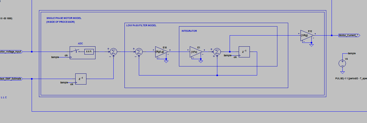

I have another question, regarding to the low pass filter, what is the original model in s domain?
In my understanding, it should be LR circuit, the equivalent resistance in s domain should (sL + R), but whatever using forward rectangular rule, backward rectangular rule, and bilinear transformation, I can't get the exact model with Dave's simulation files, can you please help on this?
