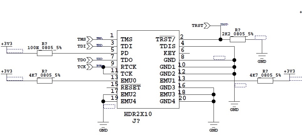

I am totally new to this MCU i am designing my own board for a customer project i need to verify the connections. If anyone could verify, it will be helpful.
I am attaching the images as i cannot share the schematic. Please refer the images for programmer connection and also i am using a flash IC with SPI

Hi Peter,
I am having only two doubts for now:
1. What is the JTAG connector that i should use on my board.
2. For GPIOHIBWAKE(GPIO41) pin 89 in PTP package should i connect
any reset circuit, if any can you please specify how to add it.

Hi Peter,
For 3.3V output as referred in TI sample schematic there is a schottky diode D1 the package is too low for layout
can you suggest some similar part or can i use any other diode with different specifications so what can they be.
I am attaching the reference PDF that i used please check and let me know.
Part reference for diode is CFSH05-20LTR-ND. Why do we need Vr =20V and Io=500mA can you please explain.tidrhv6.pdftidrhv7.pdf
