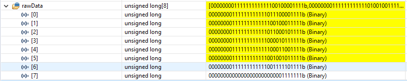

    My apologies!  I'm able to get data from the ADC, and the data reacts to changes in ADC input.  I have the ADC's MOSI line tied to 3V3 to keep the SoftSpan at +/- 10.24 V.  The results should have all ones in the 3 least significant bits because of this.  Instead, I'm getting this when 5V is applied to channels 0-6:
    Here's an example of what's actually happening on the SPI line.

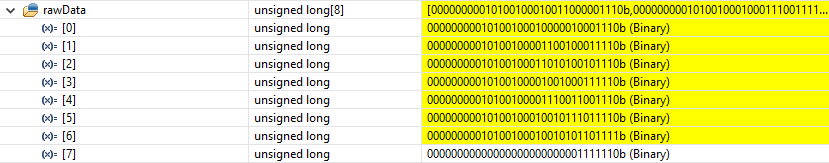

    The next three LSb's should increase sequentially as each channel is read.  It looks like this is done here if the LSb of 0 is ignored.  However, when connect to 0V, the output is as follows:
  • I found that the Launchpad is providing an inconsistent clock as shown here.  On some of the rising edges, an extra rising edge occurs shortly afterwards.  I'm not sure how it's caused or what its effect is on the data being received.
  • There's a pin on the evaluation board that I'm using (DC2094), VCCIO. It was set to the 3.3V position. The datasheet has this to say: JP2
    –VCCIO sets the output levels at P1 to either 3.3V or 2.5V. Use 2.5V to interface to the DC890, which is the default setting. Use 3.3V to interface to the DC2026.
    I was not using either of these devices to interface with the ADC, but placing the pin in the 2.5V position seems to have resolved the issue.
