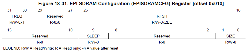

    Did you update the EPISDRAMCFG register to match your SDRAM configuration?
    -Tommy
  • Below are our settings, it is based on your example in epi_sdram.c. The only change is with the size of the SDRAM as noted:
        // Set clock divider to 1 (divide by 2)
        EPIDividerSet(EPI0_BASE, 1);
        // Enable SDRAM mode
        EPIModeSet(EPI0_BASE, EPI_MODE_SDRAM);
        // System clock frq between 50-100MHz
        // Sleep mode disabled.
        // Refresh Count = 0x2EE (default value)
        EPIConfigSDRAMSet(EPI0_BASE, (EPI_SDRAM_CORE_FREQ_50_100 | EPI_SDRAM_FULL_POWER | EPI_SDRAM_SIZE_128MBIT), 750);  // Was 512 MBIT ours is 128MBIT
        // External RAM Size (to set proper address range) 256MB
        // External RAM Address = 0x60000000
        EPIAddressMapSet(EPI0_BASE, (EPI_ADDR_RAM_SIZE_16MB | EPI_ADDR_RAM_BASE_6));  // Was 256MB, ours is 16MB

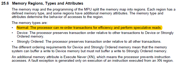

  • Drew,
    Based on your observations, I am inclined to believe that the SDRAM and EPI interface are working properly.  It sounds as though memory access works when you interactively execute code through a debug connection, but not when you let the application run freely.  Is that correct?
    Your question regarding order of execution prompted me to look in the TRM for M3 integration details where I found this:
    It looks like the EPI memory space at 0x60000000 is Normal memory where transactions can be re-ordered.
    This might explain your observations where interactive (slow) execution of code may prevent re-ordering because the pipeline can flush between instructions, but free-running (fast) execution allows the re-ordering to take place.  (I do not know for sure if the pipeline flushes at breakpoints)
    You might try to change the pointer from char to volatile char to see if the compiler will automatically generate Barrier instructions to preserve transaction order.
    -Tommy

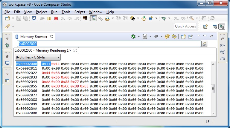

  • Hi Tommy,
    We changed the (pointer to a char) to a (pointer to a volatile char) and it did not make any difference. I checked the assembly code that the compiler created and it was exactly the same as with a pointer to a char. We did some more testing with different conditions and it is not just that we can not write to odd locations for bytes. There are other conditions that cause problems. A single byte write to an even address causes the next higher odd address to get a duplicate of the even address value.
    Below is an illustration of the six cases we see writing to SDRAM. These results are very repeatable. Only two cases are correct when running the application. Using the Memory Browser and Expression Window it all works as we would expect.
    Case 1: Single byte write to an even address.
    Command: wr 1 60002000 11
    Result: The correct byte is written with the data, but the next higher byte is written, also.
     Case 2: Single byte write to an odd address.
    Command: wr 1 60002011 22
    Result: No data is written.
     Case 3: Two byte write to an even address.
    Command: wr 2 60002022 3344
    Result: Works Correctly.
     Case 4: Two byte write to an odd address.
    Command: wr 2 60002033 5566
    Result: The Second Byte is correct, but the first byte is at the address higher than the second, not the location lower.
     Case 5: Four byte write to an even address.
    Command: wr 4 60002044 778899AA
     Case 6: Four byte write to an odd address.
    Command: wr 4 60002055 BBCCDDEE
    Result: As with the two byte write, the lowest byte is placed at the wrong end, one address higher than the highest correct byte.
     Below is the memory window after the above was executed. All of the locations were initialized to 0 before starting.
    We also did a test of memory location 2002f664. This is in the processor RAM and byte write does work correctly.
    >RD long 6e616353 from address 2002f664
    >WR byte aa to address 2002f664
    >RD long 6e6163aa from address 2002f664  (ONLY THE AA CHANGED)
    What is our next step?
    Drew

  • It looks the image for the memory browser did not post correctly. Here is the screen capture for the post for a few days ago.

  • Hi Tommy,
    Yes we have connected the SDRAM to a F28M36 control card using the TMDSHSECDOCK card. The SDRAM is installed on an adapter board and the adapter board is installed on the dock header. Below is the link to the adapter board:
    We are using pointers to short and pointer to long (* short) and (* long). We only use pointer to char for one byte writes (* byte). That's how we tested in the expression window.
    Drew
  • Drew,
    Given the setup description, I suspect that poor signal integrity and/or propagation delay might be contributing to the flaky behavior. The SDRAM signals are having to travel through multiple transitions between endpoints. Further, the path from the HSEC header to the prototype vias and through the Chip Quick adapter are probably not length matched.
    I would recommend running a malfunctioning memory write loop and scoping the command signals relative to the SDRAM CLK at the physical pins of the SDRAM memory. It may be possible to identify the culprit this way.
    Another option would be to use EPI with an asynchronous SRAM memory where the timing relationships are more forgiving.
    -Tommy

    Well it looks like this is an "eat crow" message from us. Deep sigh here. We found that both of the prototype boards that we had made had the same wiring error that was causing the strange behavior. We had it corrected and now both boards work correctly.
    It is peculiar that the debugger expression and memory browser had worked and the code did not. Before we discovered the wiring error we had put a logic analyzer on the board. There was a distinct difference between a character write using the debugger and a character write with the code. It was actually hooking up the logic analyzer that allowed us to find the wiring error.
    We appreciate all the time and effort you put in to to help us and I apologize for using up your time.
    TI has always been great at helping us in the past and we thank you for that.
    Of course you may close this issue.
    Thanks so much!
    Drew
  • Drew,
    I'm glad you were able to find the root cause and appreciate your follow up report. It's good to have closure on this issue. Definitely a tricky one to debug!
    We typically consider the CCS expressions and memory browser widgets to be intrusive when debugging external memory activity because the data refresh operations can be erratic. You might have more consistent behavior if you remove all extraneous variables and memory addresses when poking through the debugger.
    -Tommy
