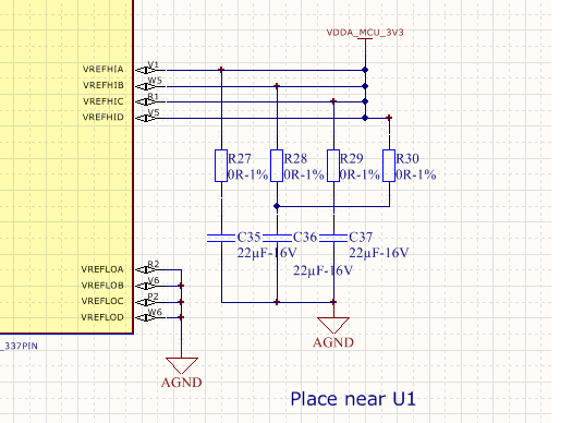

TMS320F28377D: ADC VREFHI connet VDDA
Part Number: TMS320F28377D
Although I use the 16bit differential input, but the accuracy of the analog measurement I require is not very high.It mainly measures bus voltage and temperature.I want to try to connect VREFHI directly to VDDA.Is there any risk of doing so?
