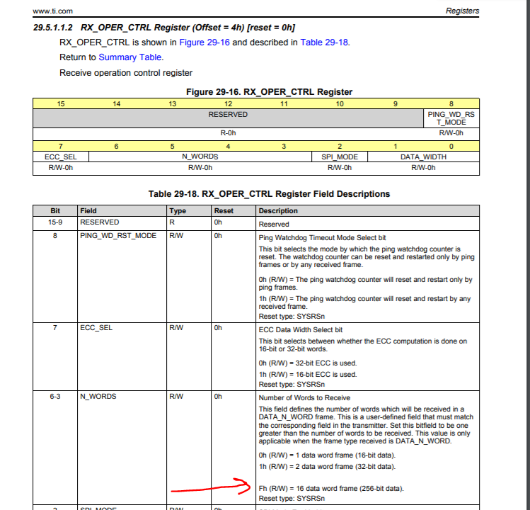

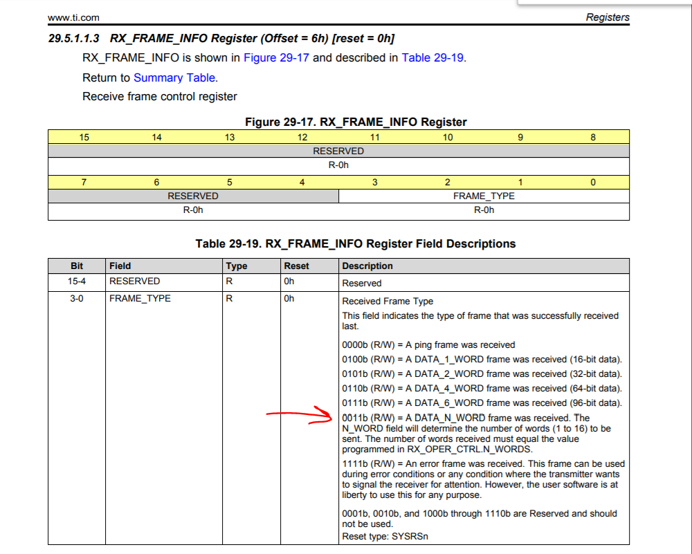

Hi Everybody ,
please some questions about FSI interface :
- payload lenght  is  max 16 words for frame  , in case of  Register Defined Data Lenght   ?
- considering a daisy-chain connection  (cf. pag. 13 “multi-axys system options”), the task to send  a frame RX/TX inside swicth is  SW managed or can the HW handle it itself ?
-in multidrop connection  , nodes addressing and bus arbitration  must be handle by SW ?
thank you very much
