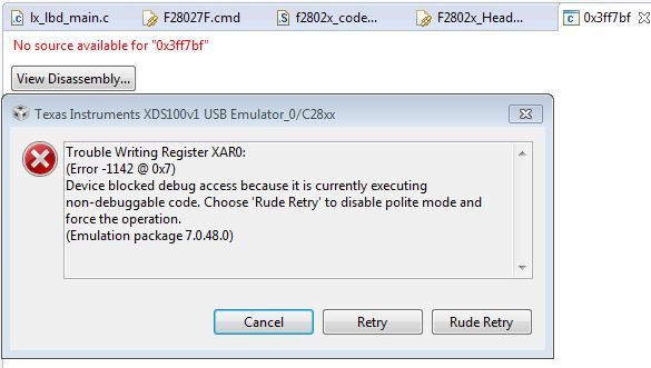

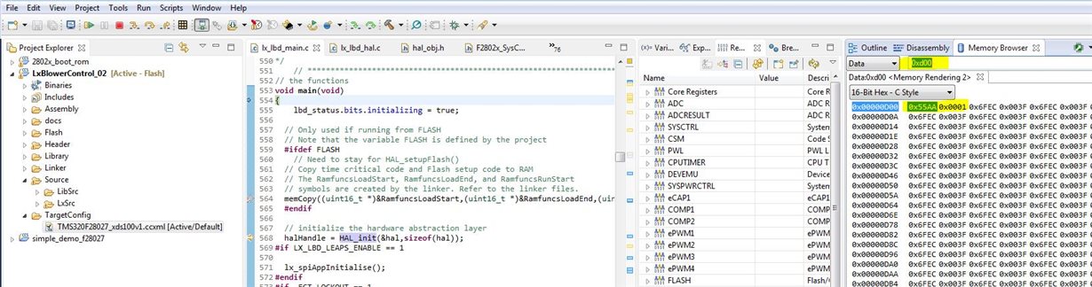

  4. With the needed GPIO settings to select mode 1(SCI boot) and we tried to load our application once again through debugger and tried to see the 0xd00 and 0xd01 registers in emulation mode and looks like Micro is went to SCI boot mode(please see the attached image).
  5. After this, we tried Scripts->Realtime Emulation Control->Run_Realtime_with_Reset. On doing this we got, No source available for 0x3ff7bf (~which is boot rom address location). Tried to send character ‘A’ from PC utility (“serial_flash_programmer.sln”) to detect auto baud lock. No response here also.
Please let us know, is our assumptions are correct and also, please help us to solve this issue.
