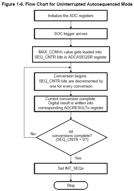

I would like to konw correct method of end of conversion (EOS) timming.
Is SER_CNTR: chage to 0 correct?
Or is INT_SEQ: chnage to 0 correct?
back ground: we use SER_CNTR to detect EOC timming, but can't detect correct timming.
