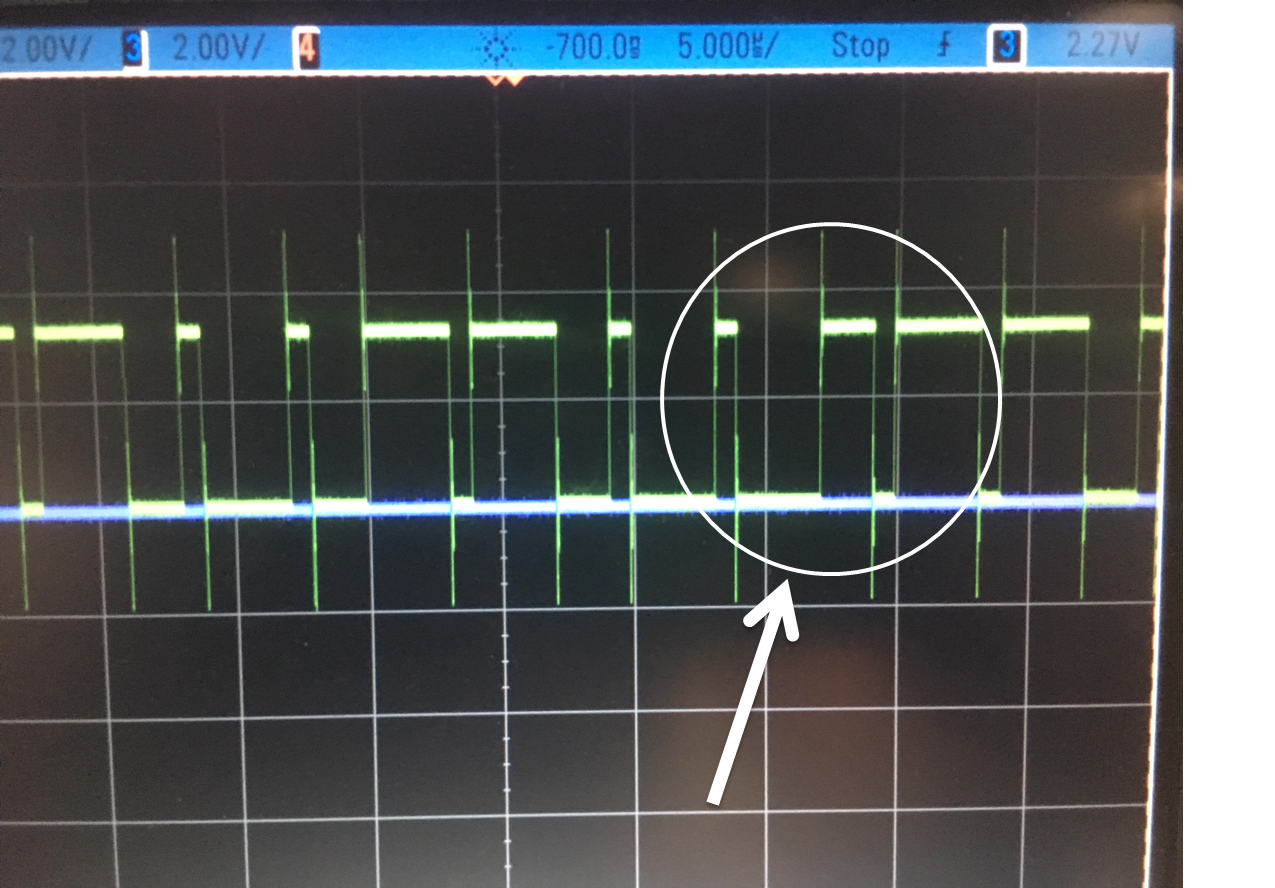

I see a strange behaviour on an ePWM when high-resolution period control is enabled. I don't need to actually use TBPRDHR or CMPAHR to see this behaviour, just setting the HRPCTL[HRPE] bit is enough to make it appear.
I have a very simple program which configures EPWM8 for up-down high-resolution period/duty control with TBPRD = 180, then switches between CMPA = 36 and CMPA = 144 in a loop.
Here is the code:

Here is a picture of the result:

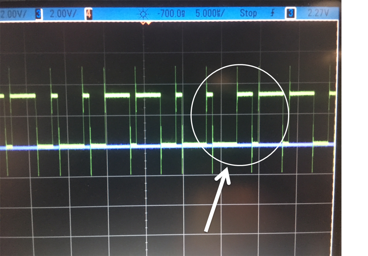

Here is the same picture zoomed in and annotated by myself:
However if I leave HRPE disabled the problem disappears and everything goes as expected.
Can someone from TI reproduce the problem using the code I provided? Is there an explanation for this behaviour?

    The response I got from the team was different from your findings. With HRPE = 0,  There still seems to be the same issue.
     do you have any idea what could be causing this?
  • It appears you can remove all HRPWM code and the issue continues to occur.

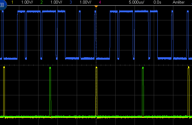

  • e2e_epwm_overclocked_fixed.zip
    Okay I just checked and you are running EPWM at 180MHz... The maximum frequency for the EPWM clock is 100MHz on this device.
    I have an identical example with the same settings as you with EPWM6 and it works fine when the EPWM clock is 100MHz. I stripped out all of the HRPWM code and the issue was always there, Then I created my own project with the clocks running off of crystal and system set to 200MHz and EPWM set to 100MHz, same exact code works.
    Nima Eskandari

    The period on my oscilloscope is 4us and TBPRD is 180.
    On your oscilloscope capture too the period is 4us.
    180*2/4e-6 = 90MHz
    If the ePWM was overclocked the period of the pulses with TBPRD=180 would be 2us.
    Therefore the physical timings contradict your explanation.
    Is there something wrong with my calculation? Apologies if it’s the case.

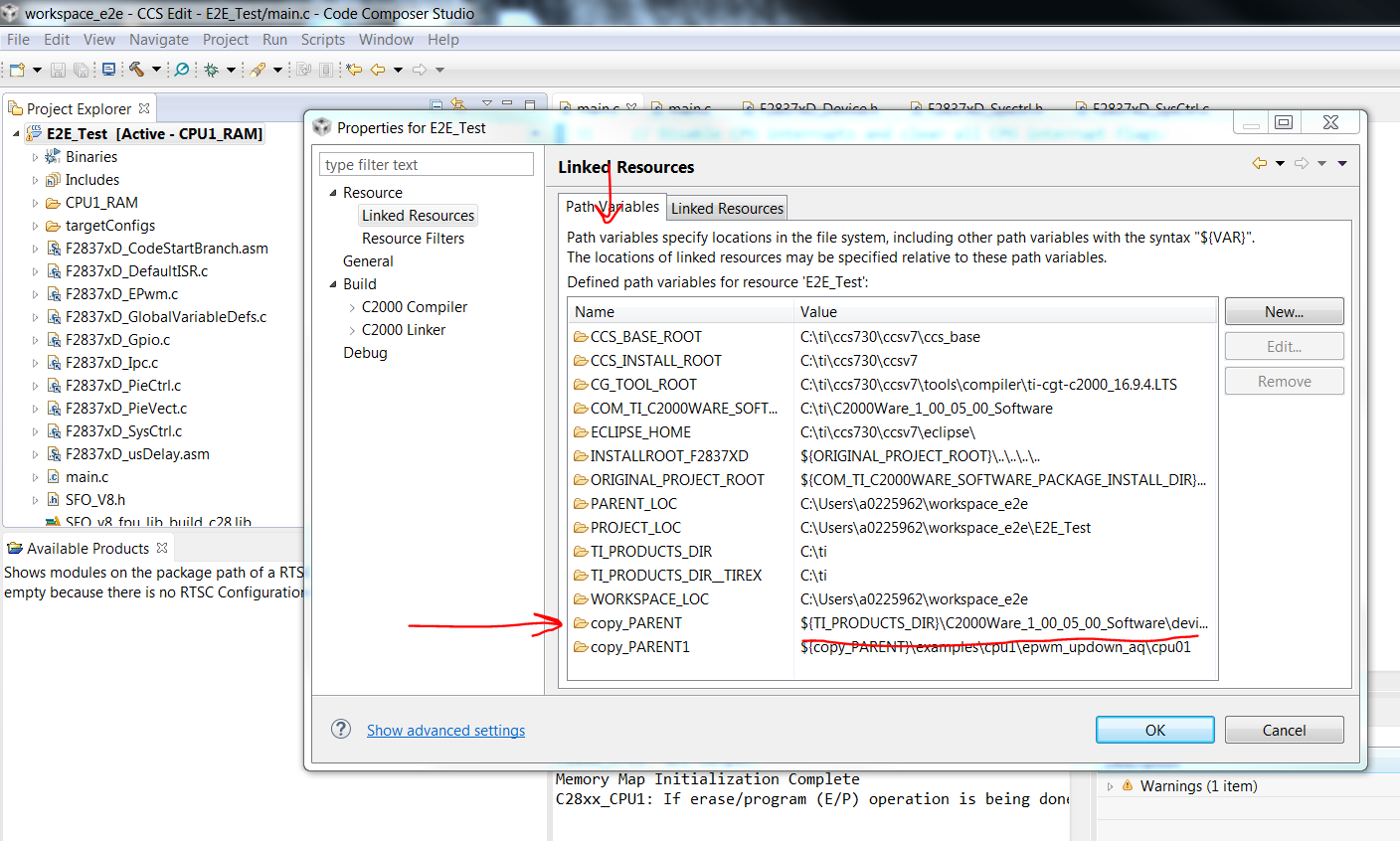

    1. Non-portable projects are inconvenient
    The project I sent you is self-contained project so that you only need to compile it and run it. My code uses the internal oscillator so that it works the same regardless of the crystal frequency (which is 20MHz on the controlCard and 10MHz on the LaunchPad).
    The project you sent me, on the other hand, has dependencies on external libraries and it doesn't compile because it has the path to C2000Ware from your machine hardcoded in it. This is impractical so from now on can we agree to stick to portable projects with no dependencies to external files?
    2. My issue is still present in the project you sent
    After manually resolving the path to every C2000Ware file I ran your project. If I uncomment the configuration of the HRPWM the issue appear exactly as I described it. Therefore I suspect that the issue you recreated is not exactly the same one I had.
    1. Your scope picture shows 5 transitions between the two values of CMPA but the issue appears only once. This does not match with the issue I described, where I see a pulse with the wrong width on every single transition.
    2. I double-checked over and over again and I'm sorry to say that on my setup the issue does disappear with HRPE = 0. It does have an influence and if your setup behaves differently then maybe it's because you're seeing a different problem.
    3. You explained the problem comes from the EPWM being overclocked but experimental results contradict this (refer to my previous answer ; 180*2/4e-6 = 90MHz). Please tell me which registers have the wrong configuration according to you; I checked the ones I'm aware of and they all seem to have the right configuration (PERCLKDIVSEL[EPWMCLKDIV] / TBCTL[CLKDIV] / TBCTL[HSPCLKDIV]) and I also checked the PLL configuration.

    1. Porting My C2000WARE project
    The project I sent to you should be easily ported to your CCS. Everything is linked, and all you would need to do to  make sure it can run on your setup is change a the paths in the Project Properties. If you are resolving each file manually, that is NOT the way to go.
    I can now see EXACTLY what you were saying on my Control Card.

  • Well seems like you beat me to it. But here is the full explanation.
    When using HR mode with UP-DOWN timer mode, you must set the load mode for your shadow registers to be PRD AND ZERO. But in HR mode this does not mean your shadow register gets updated on both PRD and ZERO. It actually only gets updated on ZERO. This is what I was not aware of and seems to be the answer to your solution. When using HR mode in UP/DOWN you want to always center the Pulse around PRD because that is what the HR mode internally will try to do.
    The reason you set shadow load mode to PRD and ZERO is internally there is another shadow of the register (double shadow) which will get updated. The user has no control over this. The user's shadow register will only get updated on ZERO and the pulses should always center around PRD.
    As always thank you Pierre for you question and your patience. Digging into this actually helped me understand the HR mode more deeply as well.
    Nima Eskandari
