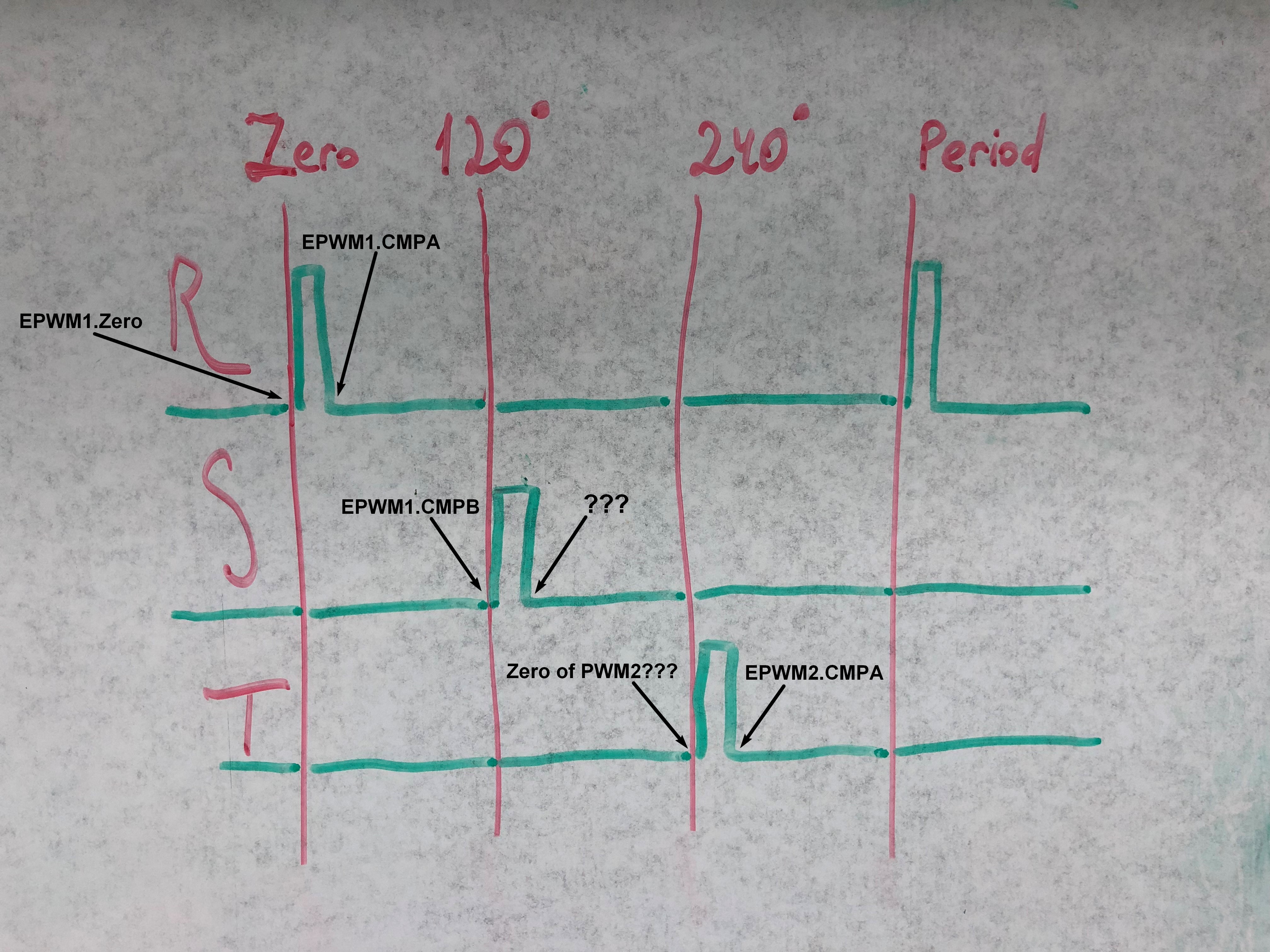

    Thanks for your reply, it explains a lot. However, I still don't see a way to implement a lower percentage of PWM. Consider the following picture:
    The EPWM*.Period is constant for all PWM channels and can't be changed, this is a prerequisite, therefore I can't use it for limiting the pulse of phase S (point labeled "???"). CMPC and CMPD are used for other purposes and can't be used for the point labeled "???" anyway. I simply don't see the resources I need to implement this setup.
    Additionally, there is a strong push to move the pulses to the center of the corresponding bands, with peaks at around 60° for phase R, 180° for phase R and 300° for phase T, in order to reduce noise while measuring currents on the phases. That means, I won't be able to use EPWM1.Zero for beginning of pulse on phase R, and won't be able to use EPWM2.Zero for beginning of pulse of phase T.
    The difference between beginnings of pulses of phase R, S and T absolutely must be 120° at all times, therefore I can't use up-down counter and set CMPA for beginning of pulse R and end of pulse S, and CMPB for end of pulse R and beginning of pulse S. In other words, the following setup is illegal:
    That leaves me with insufficient comparators to fulfill the requirements, am I right?

  • Alexey I have another idea. First, lets make things more complicated by moving the pulses to the center. I would like to give an answer to the original situation.
    Here is what I think you should do.
    Divide your original PWM PERIOD by 3. We will now have three specific conditions. AGAIN this solution is doable but you need to write the software for it.
    You need to keep track which one of the three conditions you are in (between the 3 stages).
    In the first stage, DUTY cycle of S and T are zero, and R is given the needed duty.
    In the second stage DUTY cycle of R and T are zero and S is given the needed duty.
    In the third stage DUTY cycle of S and R are zero and T is given the needed duty.
    AND REPEAT. Keeping track of which third you are in. Since your PRD is divided by 3, you can use shadow mode and get this working perfectly without HW change needed.
