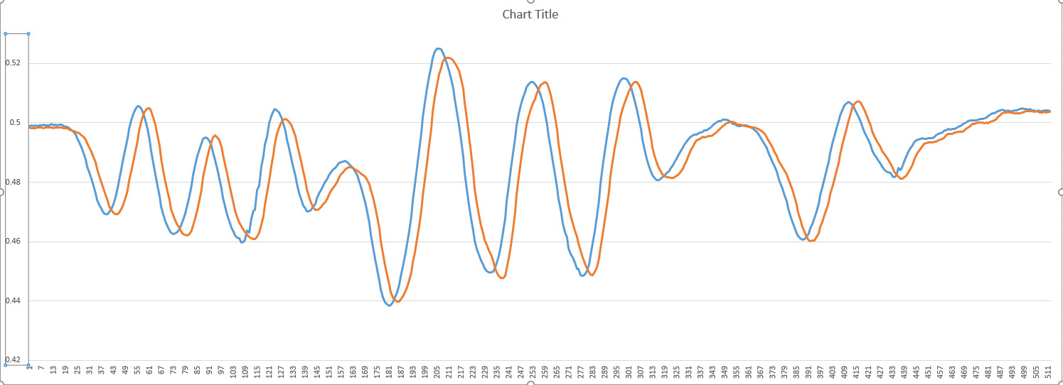

  • Thank for replay Sean, I use lab13a with small modification, where instead of setting 0 as reference  in to position controller I pass variable target_position, and there is delay between changes of value "target_position" and motor position changes. Here is my position controller run function:

  • Hi Harry, sorry for the delay in response. STPOSCTL depends on the reference and feedback, so those two API need to be run before STPOSCTL_run(). Can you try positioning these such that their calls are immediately before the SpicTAC position control function? Also, what's the SpinTAC bandwidth? You can try increasing this to decrease time from update to reaction, but it could also come at the cost of stability

    as you can see STPOSCONV_run() and ST_runPosCtl() execute at same rate but I still have delay on system response to position I set in  ST_runPosCtl()
    here is chart where system run with bandwidth 20 rad/s
    It is plotted at 100 Hz and delay between commanded position(blue line) and encoder position changes(orange line) is about 0.08 seconds.
    when I increase bandwidth to 30 rad/s the motors become noisy but it still holds position and delay is 0.05 seconds:
    I can't increase bandwidth more than 30 rad/s because it starts osculating.
  • What sensor are you using? Does the sensor have sufficient bandwidth to continue driving the position control bandwidth higher? You may be limited by the hardware here
