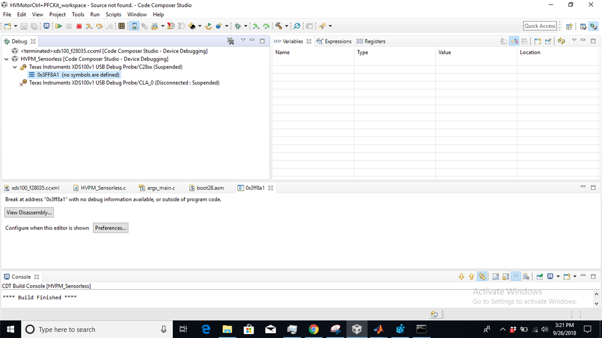

  • I am still not able to solve the connection issue. To do so, I have tried following steps.
    1. Verify that USB is correctly configured to PC.
    2. So I try to use this serial number while building
    3. Even after using this I get this suspended info:
    I was supposed to see variables load in the watch window but I could not see any.
    But I also believe, when I see the disconnect option that means the board is connected. But I was supposed to get different values on watch window but could not find any.
    Can someone also please verify this for me:
    The given documentation gives, (I am talking about TMDSHVMTRPFCKIT which has Piccolo (TMS320F28035) control card )
    So Am I supposed to have this Jumper J9 installed all the time (I don't have ISO-DIMM)? I am talking about TMDSHVMTRPFCKIT which has Piccolo (TMS320F28035) control card attached to it.Please do note I went through the document file HVMotorCtrl+PFCKit_HowToRunGuide_CCSv5.pdf. After reading that file I had doubts so I want to conform those doubts. So, will jumper be installed J9 all the time even if AC power or DC power is supplied to the board?
  • You are correct, that since you are not using the ISODIMM that you need to keep J9 shorted/jumpered. This is TRSTn signal that is needed by the emulator to keep the emulation connection active with the F2803x device.
    Matthew
