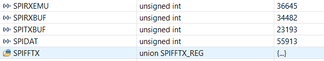

  • Data look likes the attached image for spitx and spirx buffer but the weird thing is when I connect MISO and MOSI lines together oscilloscope shows signals for MOSI pin but the MISO pin stays high forever.
    I checked the protocols for RLS , its sending desired commands
    Yes its MODE 0 , so clock phase and Clock Polarity are set to 0
    Regarding SPI clock rate , can you please explain in detail how to calculate that,
    My encoder max frequency is 4MHZ , TMS320f28069 has 90MHZ frequency, I want to give clksys /4 and baudrate equal to 9600 to encoder .
    Yes, Chip select is toggling as per requirement
