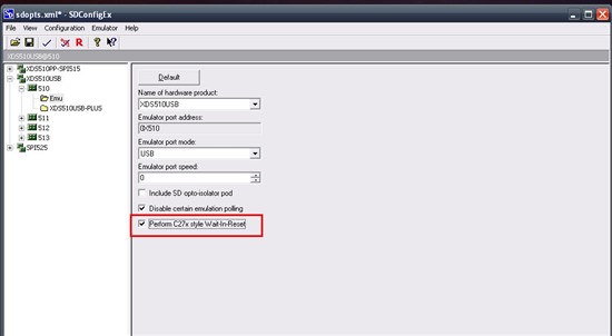

Because my board can not be changed boot pins.
  • If you don't want to change your boot pins, the only other way is to find an emulator that supports wait-in-reset. For instance, the Spectrum Digital XDS510 emulators have the option to enable "C27x style Wait-in-Reset".  If you connect such an emulator to your board, you will be able to connect without tripping the ECSL, and unlock your device.
