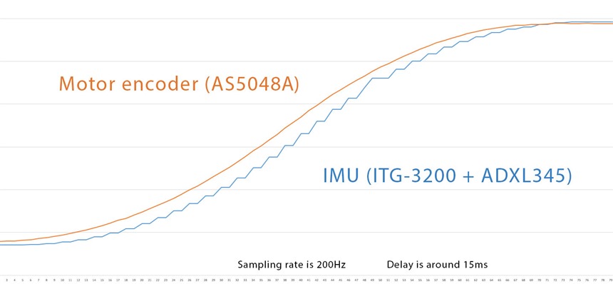

    4. Position control with IMU (modified Lab13a). We mount the IMU to the camera. IMU sends feedback via CANBUS (1Mbps) to the ESC. The system oscillates and whatever we try, nothing changes this behavior. When I started this tread, we were mounting the IMU to the frame, not to the camera. We were getting delay, as you can see from the video, posted in first message. Now we are mounting the IMU to the camera, as other gimbal manufacturers do. We tried many different combinations of settings, lower-higher position frequencies and a bunch of other things. Watch the video:
    We measured the delay of the IMU feedback. We moved the motor via Lab13b and logged both motor encoder and IMU together. The delay is around 15ms. The IMU position feedback is 100Hz.

  • Hi Roman,
    Hope you get some update on the problem. Based on our experience, with the latency on your position feedback chain, lowering the bandwidth will help stabilizing the loop or reduce the oscillation. With higher bandwidth, the same amount of time delay will translate to higher phase lag, which will affect phase margin more. If you cannot effectively reduce the delay, lowering the bandwidth will be something you will have to consider. One thing you could consider as well is to increase the INERTIA estimation result in the setting (by 2-10 times), which will normally allow you to have higher bandwidth and better performance. Thanks.
