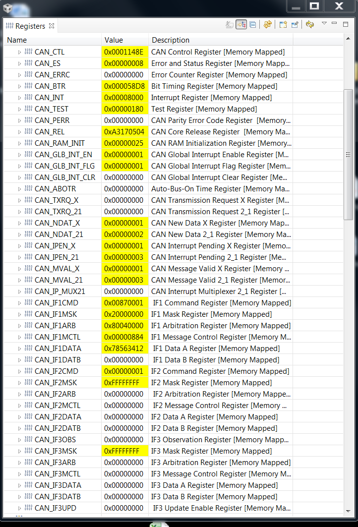

    You are right when IF3 disable.

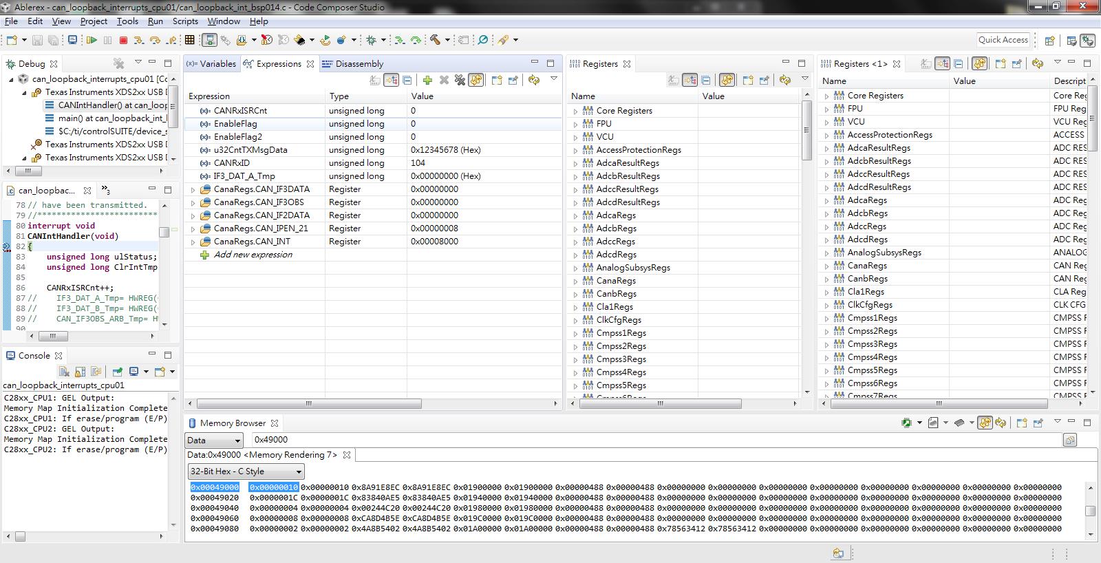

    When I set the breakpoint at the very first line of the ISR,CAN_IPEN_21 can point out which mailbox receiced the data. (as figure 1)
    After excute "ulStatus = CANStatusGet(CANA_BASE, CAN_STS_CONTROL); " in the ISR function , the CAN_INT also show which mailbox ISR.(as figure 2)
    But if  IF3 enable as with below code setup, CAN_IPEN_21 & CAN_INT have no response with CAN_IPEN_21 & CAN_INT. (as figure 3 & 4)
        HWREGH(CANA_BASE + CAN_O_IF3UPD) = 0xFFFF;
        HWREGH(CANA_BASE + CAN_O_IF3OBS) = CAN_IF3OBS_ARB | CAN_IF3OBS_DATA_A | CAN_IF3OBS_DATA_B;
    Please give some suggestions again. Thanks.

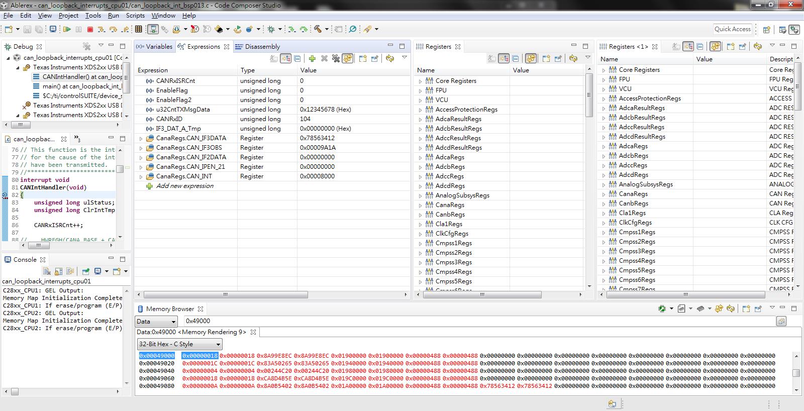

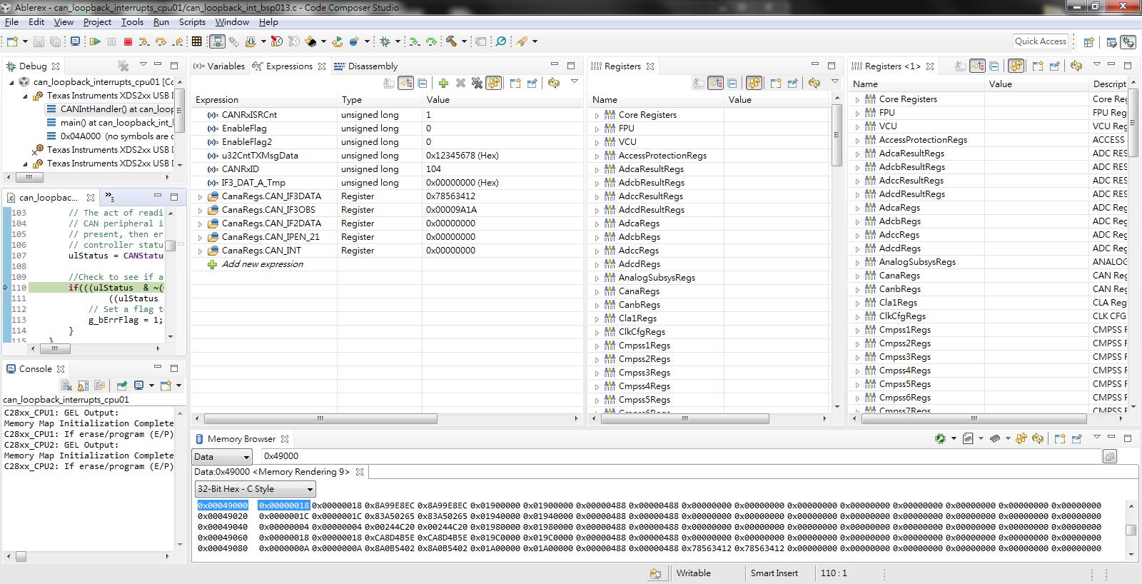

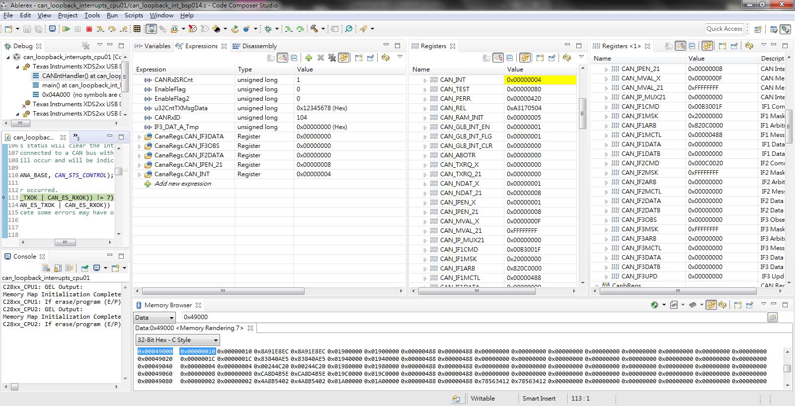

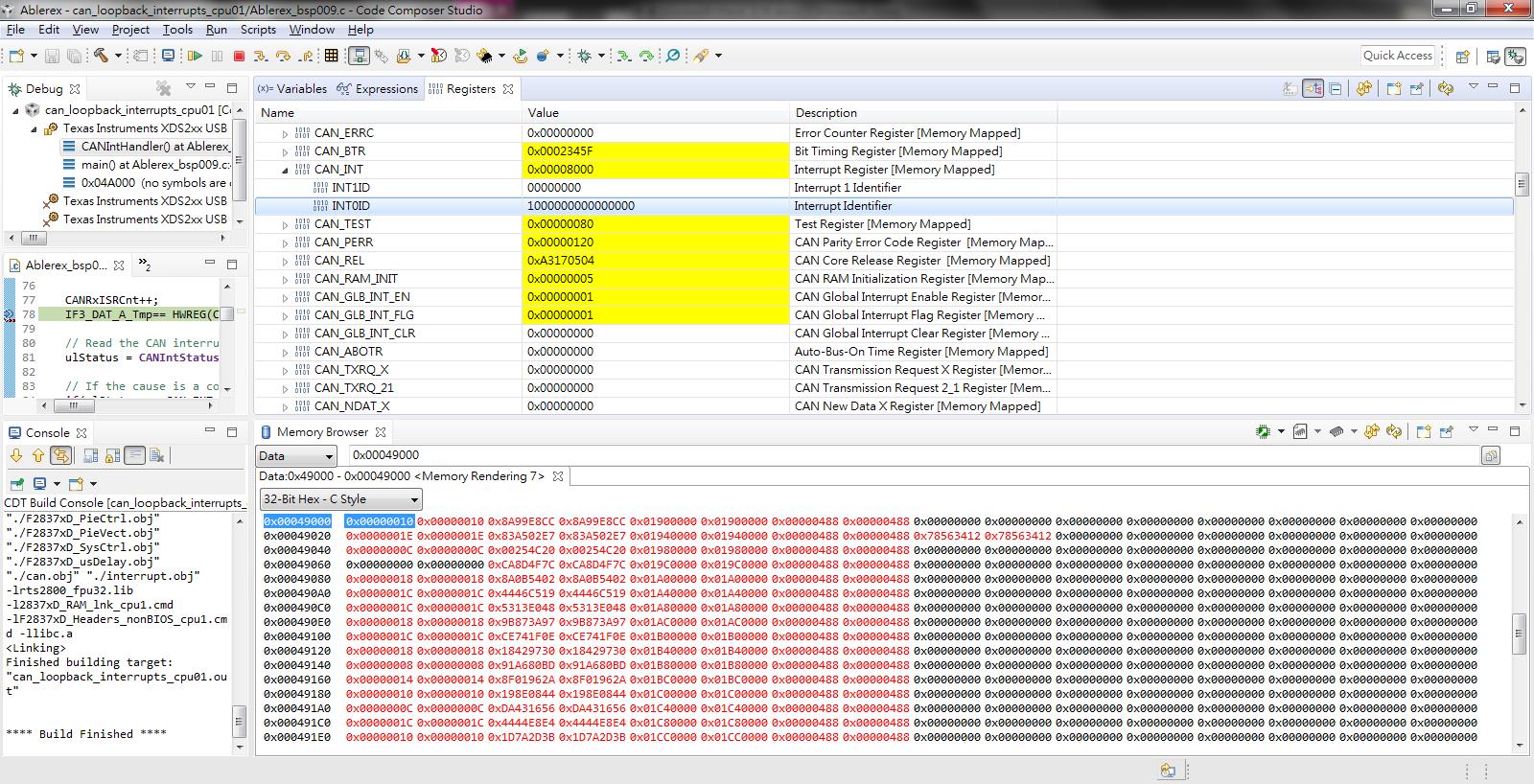

    Let me re-align the question,
    Attach file is my code which modify by controlsuite V210 "can_loopback_interrupts" example.
    My code example is sending a message to CANA from CANB.
    When debug expressions-CANRxID fill CANA message ID (CANRxID=0x101 => CANA mailbox1), and let expressions-Enable=1 ,then send a message  to CANA mailbox1 from CANB.
    Below behavior is during CANA receiving a message and causing a ISR.
    The behavior of IF1 ,
    1. breakpoint on line 83    =>CAN_IPEN_21= 0x0000 0001, CAN_INT== 0x0000 8000.It respects that mailbox1 has message and has a CAN ISR.
    2. After excuting line 111  =>CAN_IPEN_21= 0x0000 0001, CAN_INT== 0x0000 0001.It respects that mailbox1  caused the interrupt.
    3. After excuting line 171  =>CAN_IPEN_21= 0x0000 0000, CAN_INT== 0x0000 0000.
    The behavior of IF2 is the same with IF1
    3. After excuting line 170  =>CAN_IPEN_21= 0x0000 0000, CAN_INT== 0x0000 0000.
    The difference between IF1 and IF2 behaviors are that CANMessageGet() function configurate IF1 or IF2 registers.
    IF3 configures at line 421 and 422.
    1. breakpoint on line 83    =>CAN_IPEN_21= 0x0000 0000, CAN_INT== 0x0000 8000.
    2. After excuting line 111  =>CAN_IPEN_21= 0x0000 0000, CAN_INT== 0x0000 0000.
    Base on the experiment result,
    IF3 behavior is different with IF1/IF2.
    When enter ISR, CAN_IPEN_21 have no value after IF3 setup. (breakpoint on line 83)
    Therefore,INT0ID also have no value after excuting line 111.
    Why CAN_IPEN_21 can not work after IF3 setup?
    Do you have the same situation after IF3 setup?

    best regards,
    Simen
  • Simen,
    It is expected that IF3 behavior will be different compared to IF1/IF2, since IF3 is for Receive only. Furthermore, this device lacks DMA which IF3, in some measure, relies on. Will update you on what I find.
  • On a different note, you may want to move to C2000Ware, since no updates are being made to ControlSUITE.
  • Hareesh,
    Thank you very much for your kind answers and recommands.
    best regards,
    Simen
